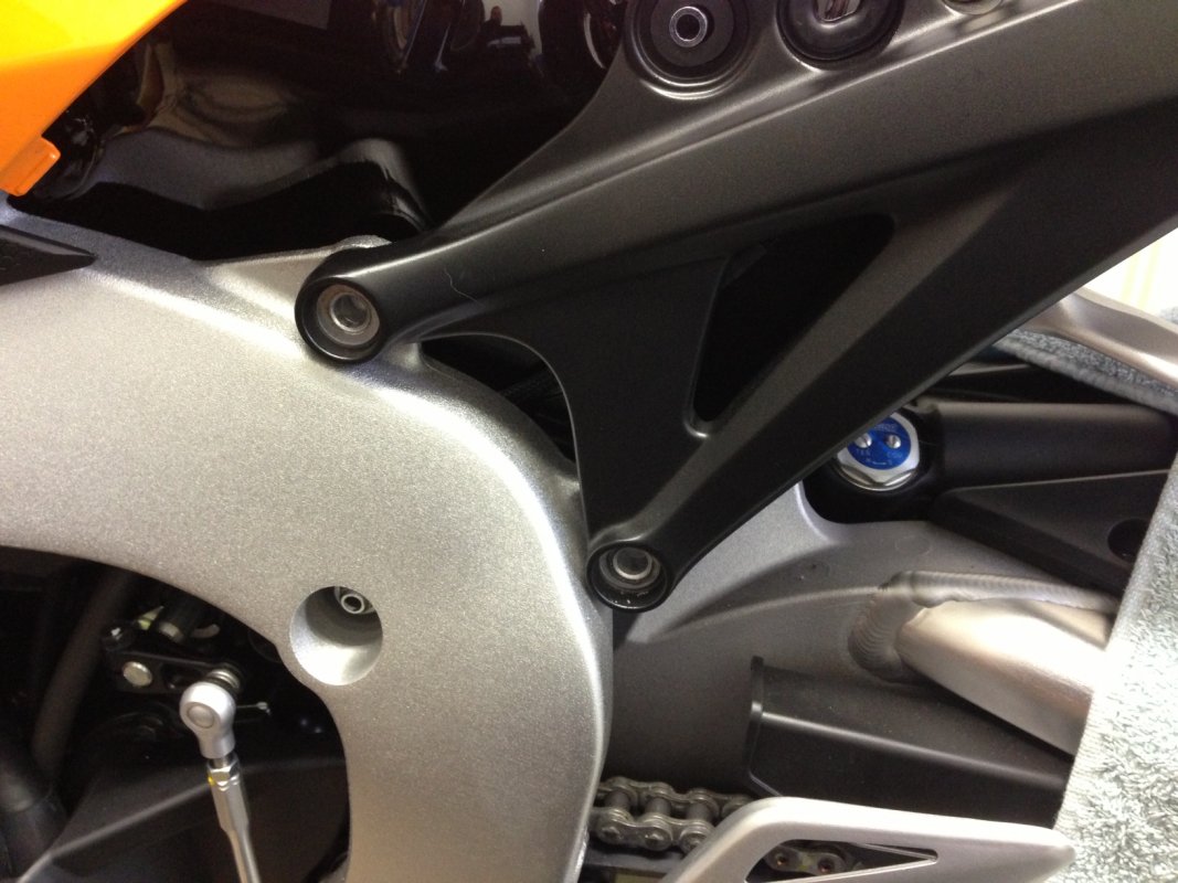

[URL=https://www.1000rr.co.uk/gallery/photos/these-two-bolts-need-to-be-undone-to-remove-the-subframe-only-do-one-side-at-a-time-in-order-not-to-scratch-any-black-paint-i-would-consider-a-small-bit-of-electrical-tape-if-possible-to-be-wrapped-around-your-socket.1712/][IMG]https://www.1000rr.co.uk/data/photos/l/1/1713-1363014306-de80bdbbe0922755718be5b434e0252a.jpg[/IMG][/URL] [URL=https://www.1000rr.co.uk/gallery/photos/these-two-bolts-need-to-be-undone-to-remove-the-subframe-only-do-one-side-at-a-time-in-order-not-to-scratch-any-black-paint-i-would-consider-a-small-bit-of-electrical-tape-if-possible-to-be-wrapped-around-your-socket.1712/]these two bolts need to be undone to remove the subframe. only do one side at a time. In order not to SCRATCH any black paint I would consider a small bit of electrical tape, if possible, to be wrapped around your socket.[/URL] by [URL=https://www.1000rr.co.uk/gallery/authors/paulbusdriver.1293/]paulbusdriver[/URL] on 1000RR - The CBR1000RR Fireblade Forum
