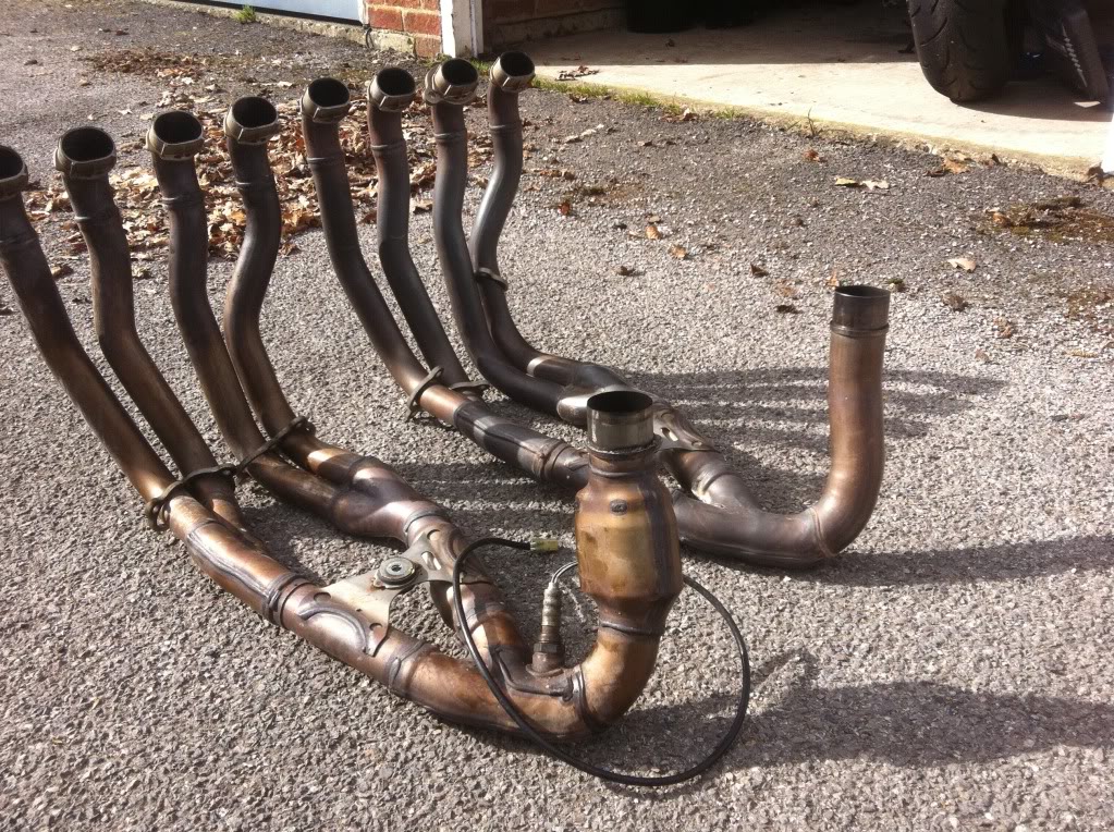

    The Cat on the 06-07 model is part of the downpipes/headers.
    I've heard of people smashing the Cat to pieces so they can remove it, but I bought a set of secondhand headers from the US as they didn't have one fitted (apart from California). Not sure if a set from an 04-05 would fit without modifying.

    Here is a pic of my standard headers along side the US headers.
