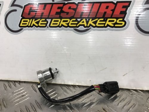

    From what I remember, the neutral switch on the 2008 has been changed to a switch used for gear indication on the 2012. The grey plug would go to this switch.

    Sweet yes that's what I found too. But the grey plug is too far away so I take it there's a wire between too?
  6. si1000repsol
    May 5, 2011
    1,673
    517
    It plugs into the engine loom of the 2012 model if I recall
    This is the updated engine plug
    This is the plug used in the 08-11 crankcase

  7. 1000rrboyjay
    1000rrboyjay Active Member
    Jan 2, 2013
    332
    180
    Oh I see. So it doesn't look like it'll be plug and play?
