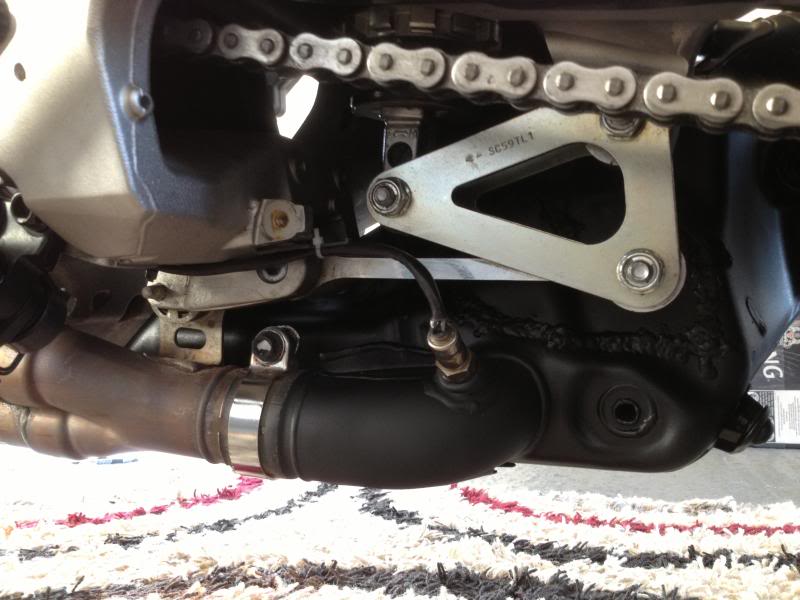

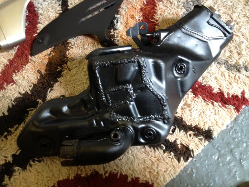

    I recently purchased stock exhaust from "Samd1985" which he had modified, having followed some threads on other Fireblade web sites. The exhaust had all of the internals removed (Cat, partitions between each chamber including the internal pressure flap in the middle of the muffler), so basically it is one big chamber inside.
    The exhaust was in good condition with just surface dirt, but I wanted to make sure it lasted after all the time and effort that had been put into modifying it, so I sent it away for sand blasting and powder coating in a heat resistant black satin finish. This is how it came back :

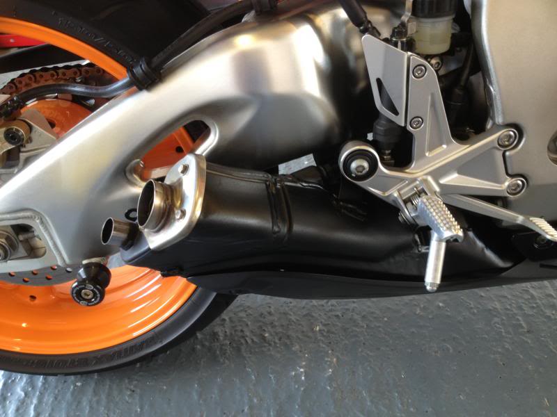

    Took my time assembling it and took advantage of the lower fairing being off and gave the bike a good clean. Kept the 02 Sensor Connected, but disconnected the Exhaust Outlet flap, so now both outlets are open all the time.
    Made sure everything lined up perfectly and it did, not adjustments needed at all.
    Was really pleased, it went back together looking totally original.

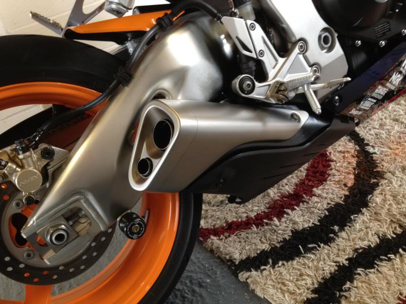

    Checked everything over, alignment and torque of all the allen bolts, started it up and wow...............it sounded fantastic, I have to be honest and say it sounds as good as any after-marked exhaust I've heard. It sounds somewhere between a bellow and a rasp at higher rpm.
    What I like is that it looks totally standard and if like me you like the style/asthetics of the original exhaust, then this is perfect.
    I was expecting some changes to the way the bike ran, but I really was surprised that it idled perfectly at the same rpm as it did with the standard exhaust on (Around 1100 - 1200rpm) with no hunting at all.
    I will be fitting a power commander and have it mapped, just to ensure I get fuelling spot on, and to make the most of the free flowing setup. But I'm happy the bike is running what I would consider as good as it was on the standard exhaust.
    So, a good day all round, finished of with a nice ride and a bike that sounded like it should have done when it came out of the factory.

    Sounds good I've done similar,and just done the flapper mod the only thing and I'm being fussy is the welding I know no one can see it but it looks like a mouse has ran all over it don't want to upset anybody but I work for a F1 company and everything has got to be just so
  5. JimGreen
    JimGreen Active Member
    Aug 22, 2012
    744
    387
    Hi Clarkey - I know what you mean about the welding, I think it looks worse than it is as it wasn't ground back. The welding is MIG/TIG, and is actually good, but compared to F1 standards I know what you mean.
    You must work for McLaren then........... living at Woking and them being so close. I pass their entrance most evening on my way to work.
    As you say though, the good thing is that the side of the muffler that you need to cut to remove the internals is the side that you don't see. as it's totally hidden.
