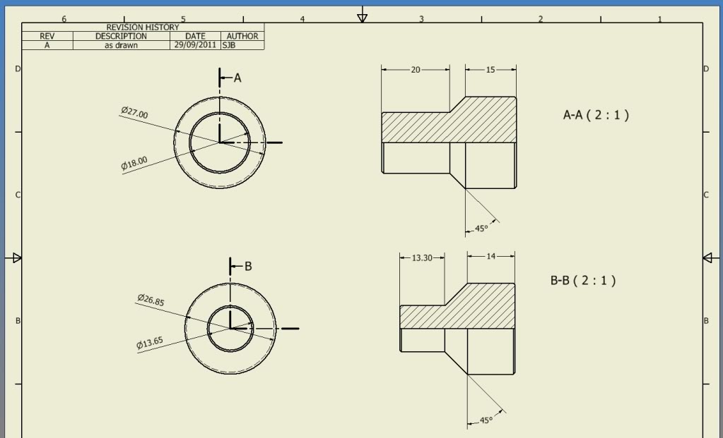

    I need to make some adaptors for my ABBA stand to fit my 2010 blade. Anyone got some that they can measure up and advise dimensions? :yes4:

    The barrel diameter for both parts that fit inside the stand recess is 27mm. The small one is thickness of adapter that goes into the bolt on bike is- 13.65mm and is 13.30mm long.
    The larger version is 18mm that goes into the bike bolt and is 20mm long. These were taken from my abba version that are only a month old.

    PS they have a 45 degree chamfer that radiates towards the stand.

    So, it should look a bit like this......

    Yes, having a diagram is much easier to work with!!
