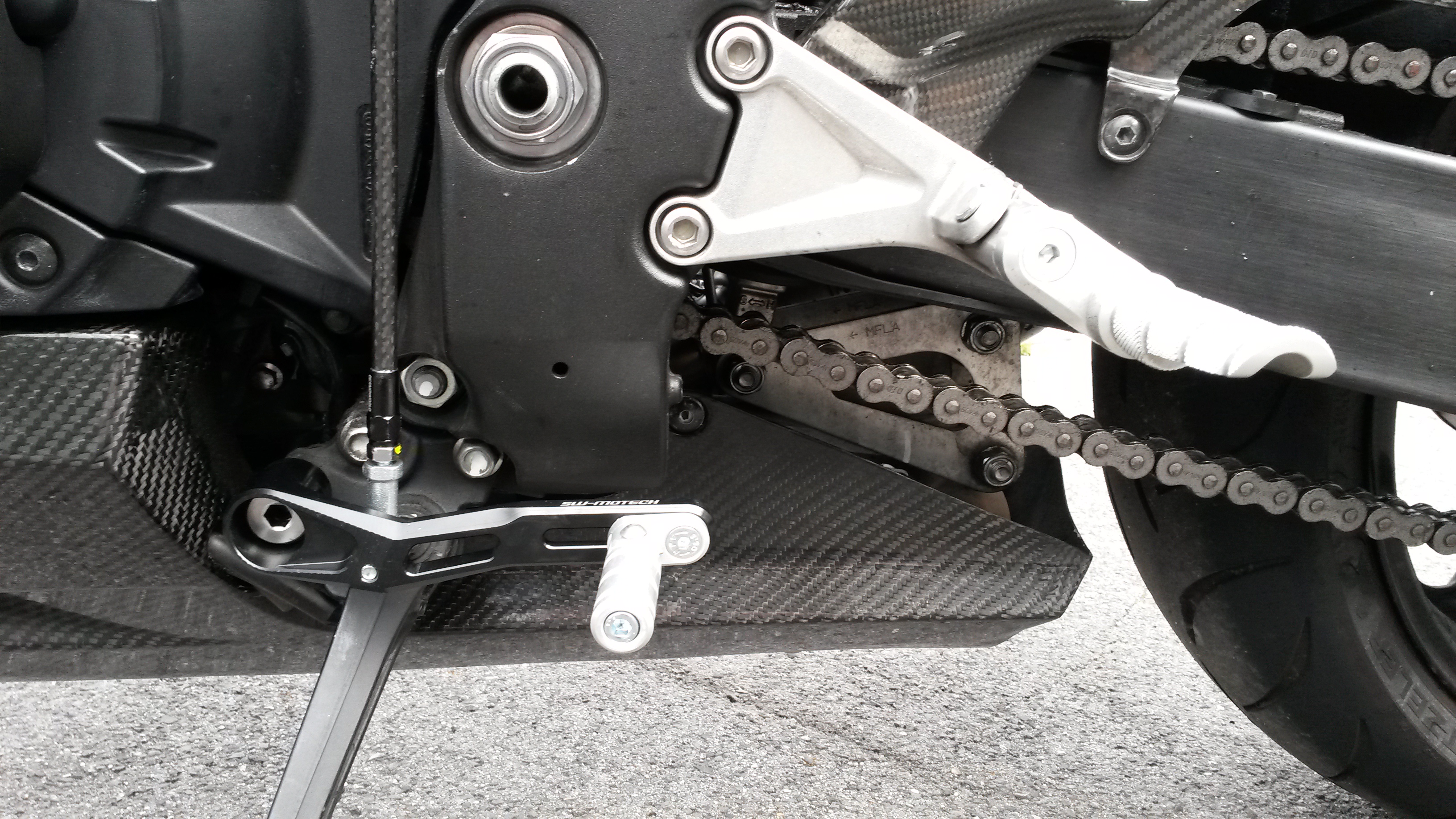

I'm finding my gear lever a bit cramped - not an awful lot of room between it and the pegs. I can go the full adjustable rearsets way, but I was wondering if anyone had seen an adjustable gear lever that just replaced the standard item? Thanks
For my 2010'er Fireblade I use the adjustable gear lever from SW-Motech. They are originally made for the CB1000R SC60. But they fit out of the box on a CBR1000RR SC59. http://shop.sw-motech.com/cgi-bin/c...10000__b&id=5&gesamt_zeilen=5&typid=202688744 Simply mount the SW-Motech gear lever and adjust the length. Fits perfectly.
