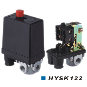

    Where does the air blow off from the safety valve or from elsewhere?
    Safety valve should look something like below pic.
    The pressure switch as below pic is most likely the cause of your problem, it normally has a screw adjuster under the plastic cover which might be sticking or needing adjusted, once correct pressure builds up in the tank the pressure switch cuts power to the motor and power cuts back once pressure in the tank drops below threshold.

    Yeah agree with shinysideup ;)
