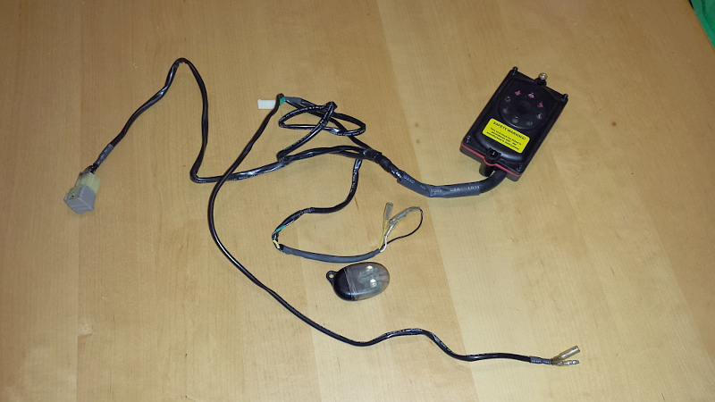

    I had a problem with my battery getting flat in my RR5. All because of Datatool 21 Alarm System fitted (since new apparently, masochist previous owners). It sucked.
    So with some tools I fixed it yesterday...
    The best mod to my RR5 so far.
