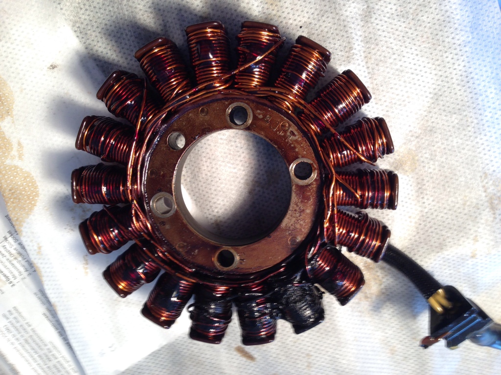

  17. F1reblade
    F1reblade Active Member
    May 30, 2013
    363
    130
    I've done just that as per attached pic. To be fair it's not as bad as I was expecting but at least two of the coils are toast. I'm assuming it's best to replace??[​IMG]
  18. bandit_287
    bandit_287 Active Member
    Jul 11, 2012
    288
    57
    That is toast mate. Only long term fix is to visit Mr.Honda and buy the updated OEM matched flywheel and stator. Circa £350.00 inc VAT. You can replace/recondition the stator but it'll only happen again in a few thousand miles.
  19. masterblader
    masterblader Active Member
    Jul 27, 2011
    226
    53
    On my 2004 all 18coils were burnt to a molten gunge.lol. So glad you got a result F1
