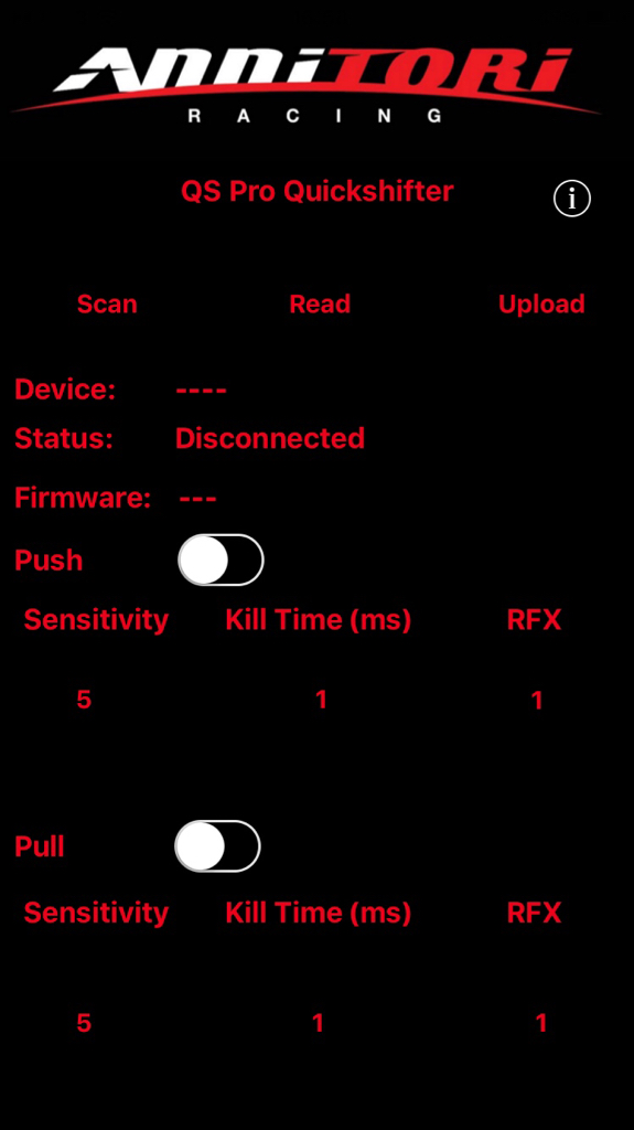

thats worth knowing! might give these a try and see how it goes, guessing the app is just kill time and pressure on lever? or can it change push/pull?
That's a screen shot from my phone of the app No info on the screen ad I'm not near my bike. Sensitivity and kill times are adjustable and the sensor can be set for push or pull Sent from my iPhone using Tapatalk
I would say either road or race shift I wouldn't try to go down the gears Sent from my iPhone using Tapatalk
No, it depends on bike fitted. Some bikes are 'push'... some are 'pull' ... you need to look at the linkage. But being a strain gauge the sensor works both ways ... but DONT try and change down without an auto blipper fitted!!! Likewise DONT change from 1st to 2nd gear with one fitted. I run an Annitori on my own bike ... it has been on over 10k miles and is smooth as silk... only gets a little clunky at high revs / low gears which is expected as they cannot be adjusted via gear / rpm like some of the top end HM racing units.
