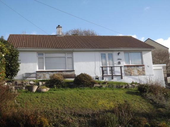

    After a bit of advise.Im in the process of buying a new house and selling our current home. The one were buying is in a prime location for us and is detached and very spacious. It has a 24ft long garage thats been the main reason we want to move. The downside is the bungalow and its attached garage is in an elevated positon to the extent that i wouldnt be able to get the car up the drive due to the steepness nor be able to park safely on the drive. Any one make a rough guess on price to demolish and rebuild the garage after digging down to make it more level with the road. It would be reattached to the house and just have a flat roof. Thanks guys as in a bit of a dilemma.

    Might be worth putting a couple of photos and the difference in height up dude ...? How did the other people get there car into the garage ?

    hi giv, i,ll try and get some pics tommorow. current owners been there 40 years but have no car anymore. i would guess the garage would need to be lowered by approx 1.5 metres. the place is perfect otherwise but my main reason for moving is a garage to keep car and bike in with main car out on drive.

    Doing what U suggest Rocket could be very costly.
    It's not quite as simple as knocking down the old Garage, digging down another 1500mm then rebuilding as the foundations of the existing house will be above that level so would just cave in.
    Also there's a good chance the Garage is also sat on the same foundations and is a continuation of the House wall, i.e. the brickwork is keyed in to the House.
    You need a structural engineer for advice and do-ability and then when a plan has been formulated an Architect to draw up some plans for a builder to execute.

    Yep, it's the pro's for that. It's a chance you have a raft foundation across the lot as Sine said. Without looking Martin's idea doesn't sound a bad one if you are happy to lose the garden/slope. If money is no issue get the Engineers in. Good Luck.

    hi guys, thanks for the replies. i went back again today with a builder and the best option is as martin suggested is to start the drive to the left come across the garden then sweep around to the garage door ( a neighbouring property has done similar and there even more elevated than this one). should be about a £5-£6 k job but a lot cheaper than rebuilding what is a nice garage to start with.
