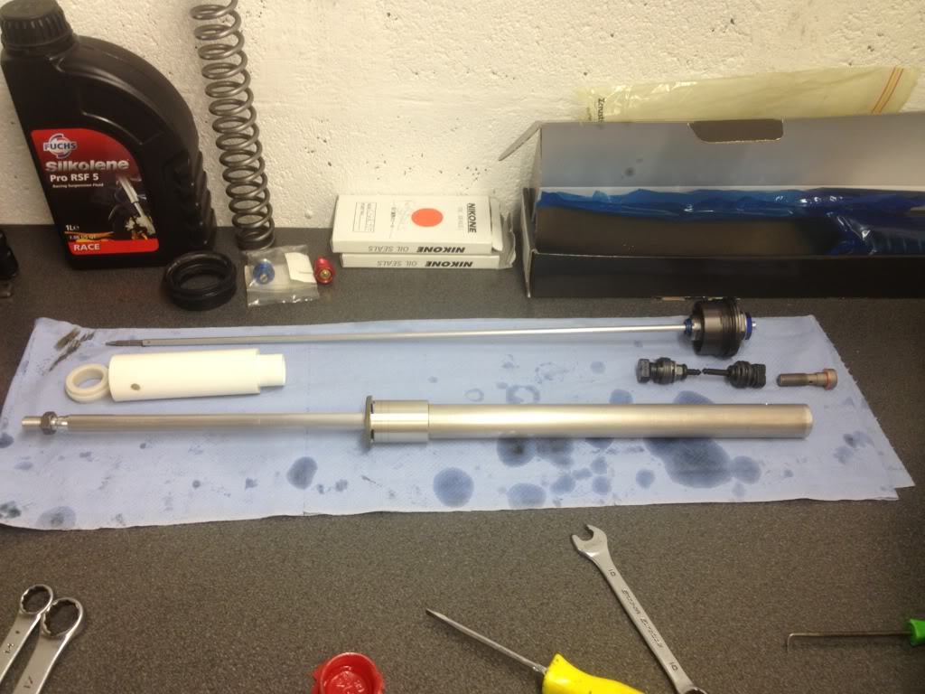

    Can I weigh in here tyke?
    This is the Broken down cartridge tube found inside the USD forks!
    Now if you just had a cartridge kit fitted the whole thing is swapped out an replaced with another unit!
    If you had a piston kit fitted which is what I was fitting in the above picture which is the small units that can be seen next to the rod, ohlins units fitted onto the rod and old showa units lyin next to it.
    The actual OEM cartridge tube is reused for the upgraded piston kits!
    Hope that clears up any confusion. :)

    Jamie,
    You really should have got back two large springs and four pistons (valves or internals all meaning same thing).
    I also swapped out springs to my weight as can be seen in the pic above, new spring still in the blue wrapper in top right old spring standing upright.
    The pistons should be a pair per fork, one rebound piston and one compression piston.
    The pistons can also be seen in the above pic, the rebound is the one that attached to the bottom of the thick rod. The compression piston is attached to the small unit with the bolt attached next to the thick rod.
  7. ShinySideUp
    ShinySideUp Elite Member
    May 22, 2012
    2,100
    1,111
    Both the ohlins springs I used above weigh about the same as one OEM spring! That's the first thing I noticed when picking them up.

    Mark,
    This pic shows the cartridge built up again with the new ohlins pistons inside, the old pistons are lying just above the cartridge.
    A cartridge kit will come with upgraded internals already inside so it's just a drop in unit rather than having to break open the OEM cartridge and change the pistons or internals over!

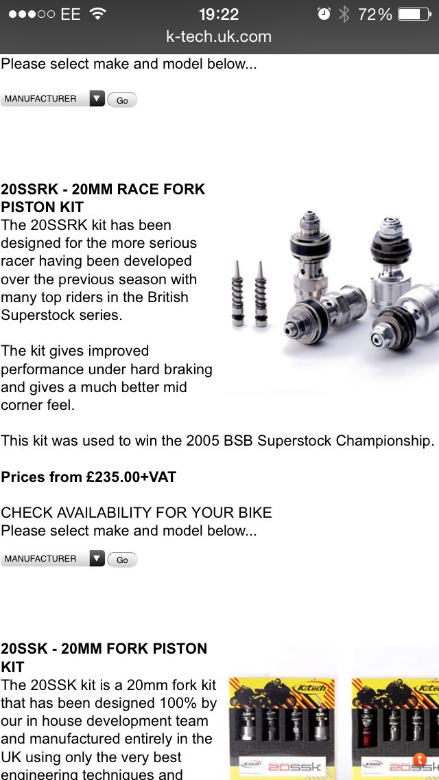

  20. wedgiewolves#223
    wedgiewolves#223 God Like
    Apr 7, 2011
    3,955
    2,314
    Mate this is what you have had [​IMG]
    Full cartridge would have a different fork cap start getting into ££££££ then . I had the same as you done with springs and full fork and shock service
