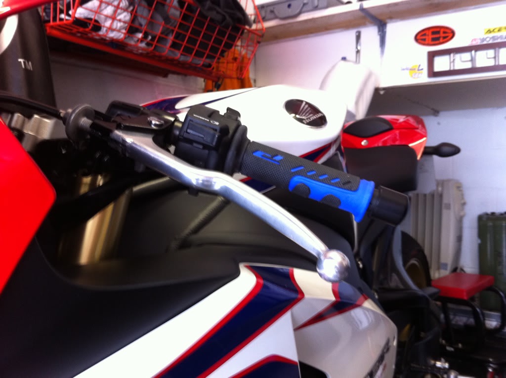

    fitted these pro grips though to try. they do seem softer on the outside and the inner layer feels the same as OE so maybe they will work.
    a bit bling for me but they only had blue or red in stock

    tried these grips out today and they DO work!!
    not 100% solved but certainly loads better than standard
    i would recommend you try some pro grip gel grips if you suffer from numb hands on your bike.
