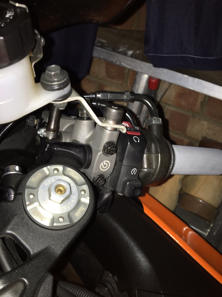

    Make sure you have the lever fitted where it's comfy, I made these mistake of bleeding it all up then I needed to move it. Then I found the banjo hit the fork tube do I had to undo it all move the lines round a bit then re bleed.
    How are you mounting the reservoir, I bought a different coupling from Carpimoto.

    does the standard reservoir not work with the rcs ( i have a new bendy bracket to fit it to )
    if not , which reservoir is required ?
  12. sps170373
    sps170373 Moderator
    May 24, 2013
    7,860
    3,092
    Yes it will fit but you might need a different clip for the hose to attach to the mc! I used a small hose clip
  13. tuktuk
    tuktuk Elite Member
    Dec 2, 2015
    2,011
    1,320
    As sps says you can use any reservoir pot, i just bought the one with all the kit but should really have bought just the unit and used the oem pot with ladybird bracket.
