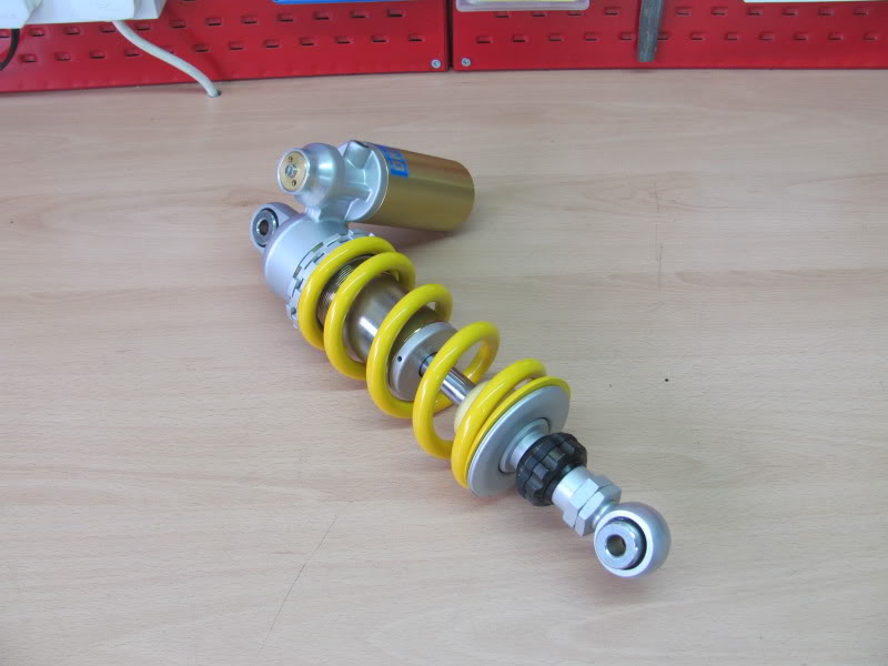

Thought I'd start a build thread. It's going to be a streetfighter, here's what I have so far, 93 cbr 900 lump, OZ gold Aprilia wheels, complete gsxr 750 K9 front end, new Ohlins shock, Aprilia rsvr swing arm. The rest of the bike will be hand made by me :crazy:

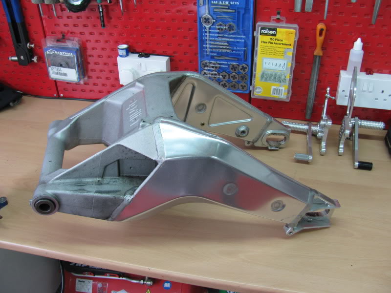

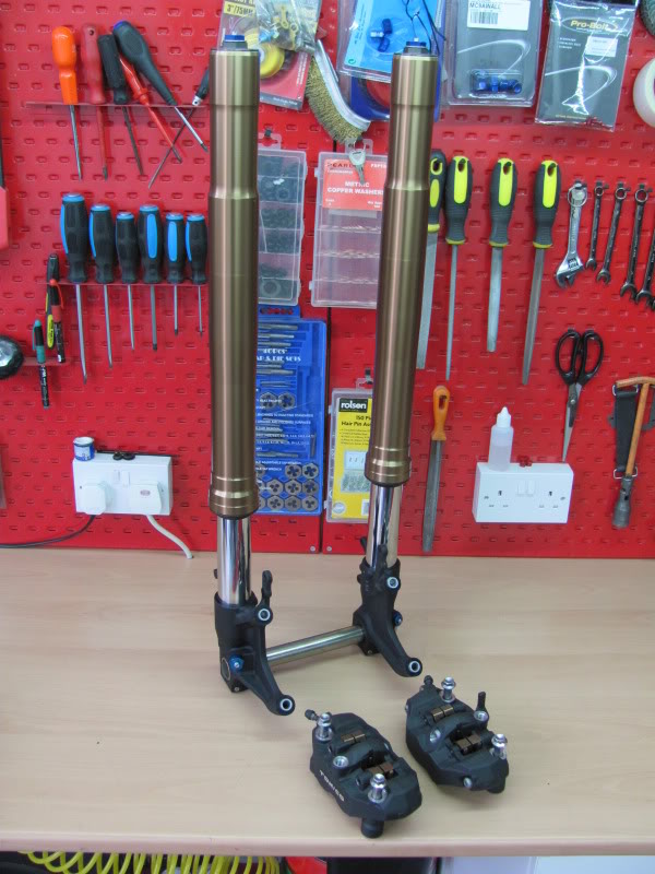

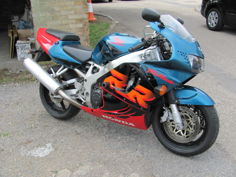

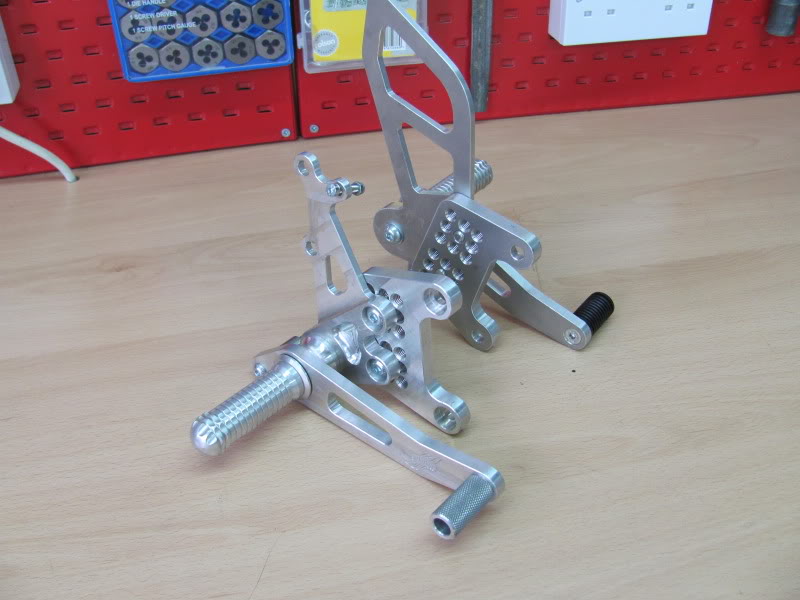

Well it's been a busy week shopping for parts but I think I'm almost done. Got a super set of OZ wheels shod with Racetec rubber A mint condition gsxr K9 front end, I sent the yokes to streetfighterbling.net for them to make a billet set One set of billet rear sets, not sure what bike they are for. (the heal plate will have to go) Got a new shock RSVR swing arm And the engine, electrics etc from this blade, 1999 with 24K on it, I bought a complete bike as a donor just for peace of mind as I know the engine is sweet (the other side of the bike is trashed, lol) I have ordered the alloy to make the frame and the turbo is sorted, time to get building

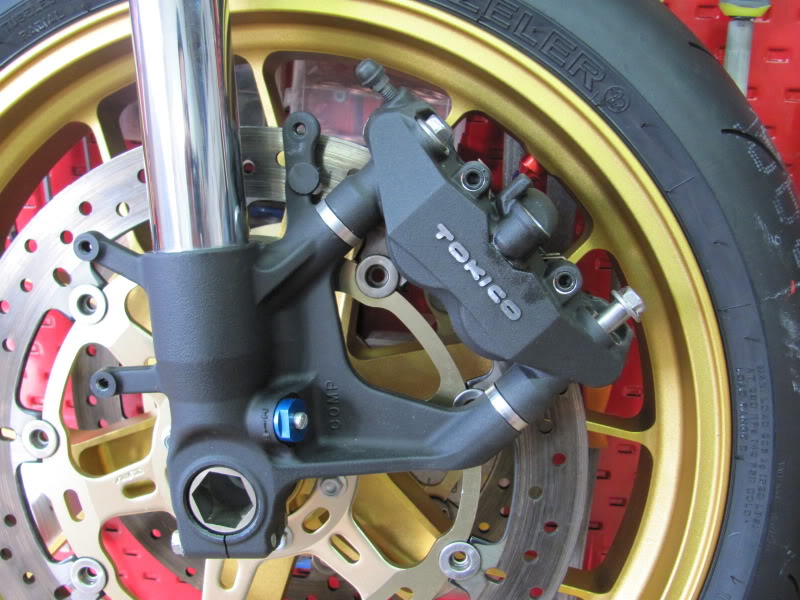

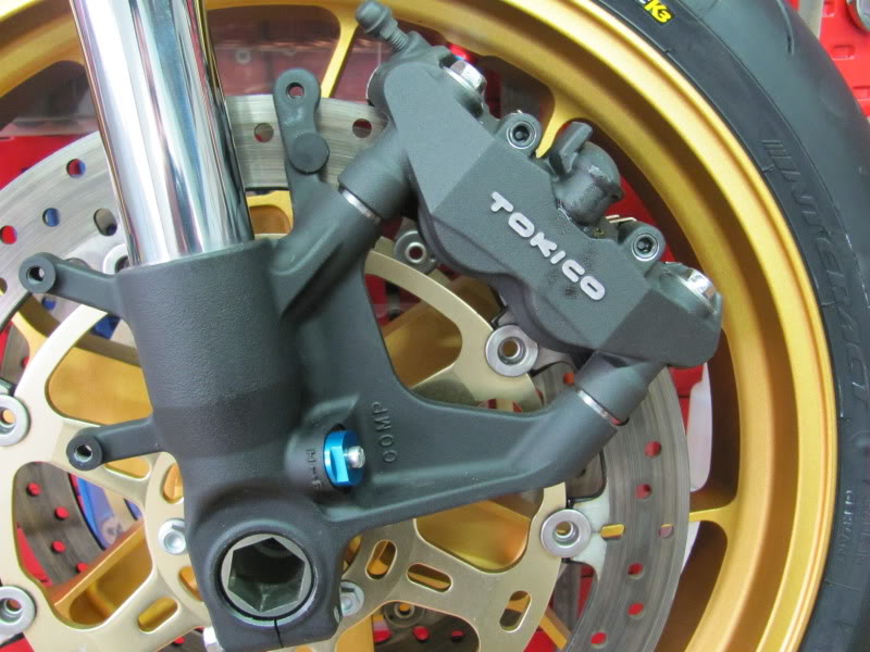

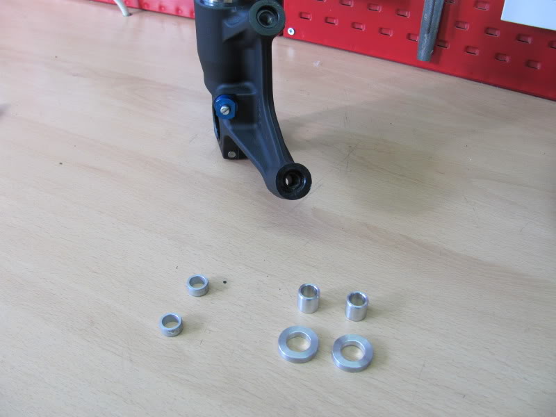

So made a start fitting the OZ Aprilia wheel in to the gsxr forks, the spindle (axle) is the same size so no need to change bearings and inner spacer, disc's on the gsxr wheel are 137mm apart, the disc's on the OZ wheel are 133mm, if I was using the gsxr yokes I would have made 2mm spacers to go between the wheel and disc's, but as I'm having billet yokes made I have told the CNC guy to make the yokes 4mm narrower, job done. Next problem is the gsxr disc's are 310mm and the OZ disc's are 320mm, this means I can't bolt the calipers down To solve this I pulled the standard locating tubes out and made longer ones with 5mm collars Problem solved, caliper locked down and disc's clear of caliper Just need to make a spindle spacer to centre the wheel in the forks but I'll have to wait till the yokes are made.
