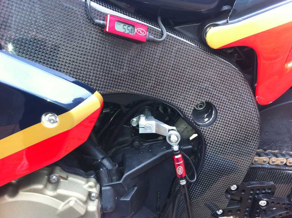

Well got my HM for my 2012 cbr1000rr so wanna go get started on fitting it but waiting for hrc throttle and cables to arrive might aswell do together
Ah I wondered which way sensor went up ha ha thanks for pic deciding where to mount the LCD what kill time etc you all running ?

I thought I could live without the HM when I sold the blade, so sold it Then I realised my big mistake, contacted our resident bling dealer Arthur and he sorted me out (sometimes I wish I had a drugs habit it would be cheaper ) I had translogic before fitted to the R1 and IMO the HM is smooth and precise the translogic missed a few shifts here and there, adjustment was limited on kill times, you cannot alter push or pull like you can on HM so can't swap to race shift if you wanted or bikes.
