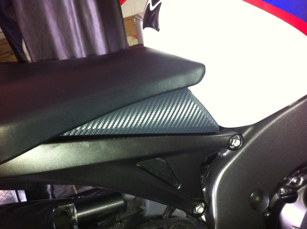

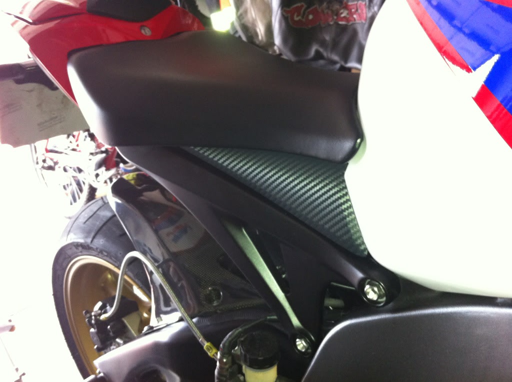

    did a bit of carbon wrapping today. i had a load of 3M wrap left over from my car so gave it a go on the bike and turned out pretty good!

    yeah just cut it oversize then really heat it up with a hairdryer and push the air out and fold edges over. for tight corners a cut may be needed. if you leave the folded side long it sticks better if its too code to the edge or flush to the edge it can lift back off

    It's pretty easy to do. Just use loads of heat and begin with an oversized sticker for plenty of overlap
    My mate has done his forks and undertray on his White 08.

    Looks great:smile: carbon Hugger looks sharp too! have you go tthe mudguard in carbon fibre too?

    I think I paid about £20 for a metre of 3m di noc sheeting. It's not that expensive really.
    Yeah my hugger is a king carbon one. It's nice quality but has the odd stone chip and a little chip where I had a nail in my tyre which hit the bottom edge. Suppose you have to expect stone chips on these. They get some abuse.
    They do work too. My mate has a standard one on his 08 and when we got home his back end was scruffy where mine was pretty clean still.
    Yeah I was thinking about maybe fitting a carbon front mudguard but not sure how it would look on a HRC cor scheme?
