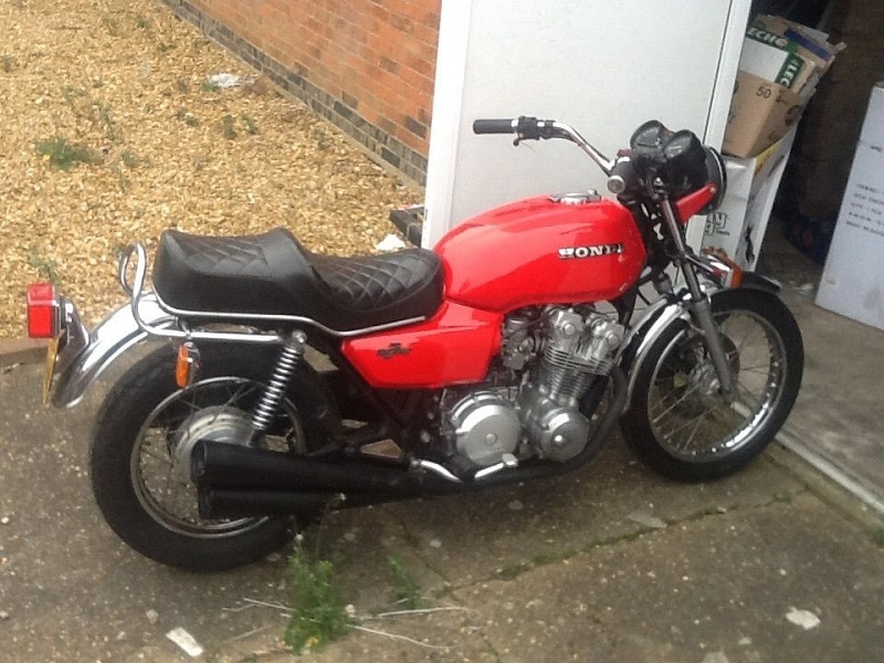

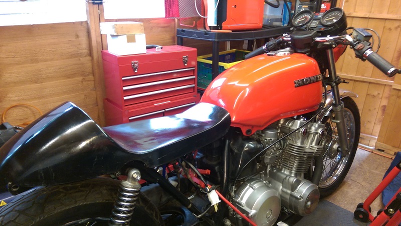

    I picked up 1981, CB750 K a few weeks ago. I have done loads of work to it already, but this mainly boils down to getting it to charge, and am still trying to get it to run properly, but its all slowly getting there.
    The pictures below are one when I got it, and the other with dropped bars and a seat literally thrown on. Excuse the different camera lights and therefore different colours, but its the same bike :)
