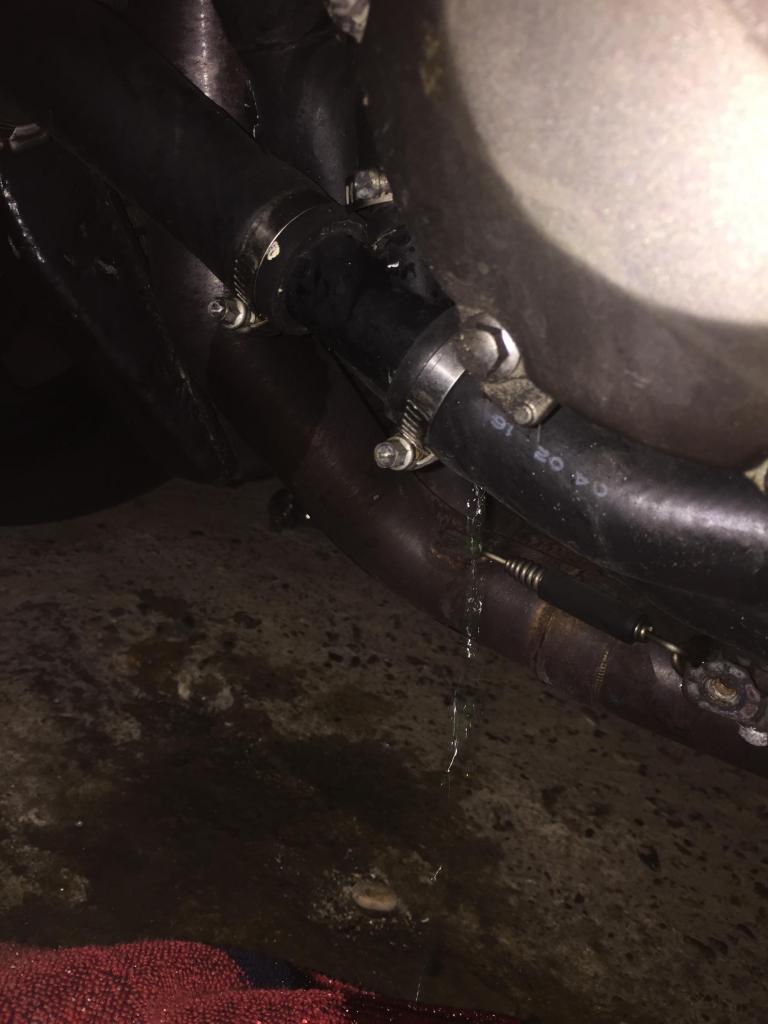

    So I just went to have my first proper look.
    Took the fairings off and nothing was immediately obvious as the problem, radiator didn't have a gaping hole or anything. Opened up the radiator and poured some water in and heard water coming out fairly rapidly.
    I looked under the bike and was greeted with this:
    A nice clear green trickle, no sludge, no muck, just coolant.

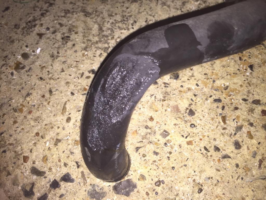

    So i poured some more water through and find the pipe it was coming from:
    The exhaust system is an aftermarket one, and obviously wasn't installed with the correct guards or whatnot.
    I gave it a very quick start up (10 seconds or so) just to see how it sounded, and it sounded absolutely fine.
    I'm going to try and find that hose from somewhere, make sure everywhere else is sealed up, check oil etc and then start it again and see if I got away with it this time.
    If I have, I'll feel bloody lucky and know never to be so stupid again!
