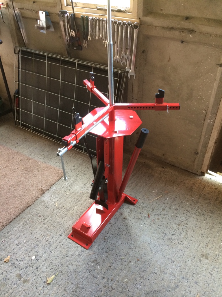

  10. Jamiestrada
    I just got this it's so much easier
    It will pay for itself over the years :) also have the alloy mate bar so no scratched rims :)

  13. Jamiestrada
    It is now ! Jesus scooby let me get it out the box ;)
  14. Muffking
    5,905
    2,846
    Is that the Sealey one? Been considering one of them for a while, although space would be an issue.
  15. Jamiestrada
    Yes it's the tc965 If I remember correctly, sold the cb1000r stand I had kicking about and the bead breaker to get this as this will be a lot easier :)

    they take a little practice to get used to them,but once you know the little techniques it really is a doddle changing they tyres.
    mine is a sealey rip off (neilsen I think) and cost me 130 quid
