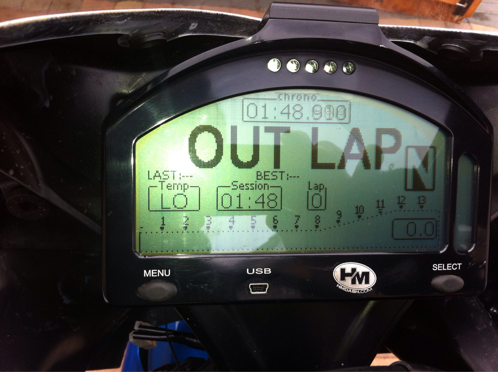

Ive just bought a HM dash for my 2010 blade rang round for prices got 10% off at padgetts and dave and jordan . a little dis appointed as not totally plug and play on the blade if you want the gear indicator to work , check up dates on HM,s web site you have to cut one wire . with the translogic you have to hard wire it all
what wasn't plug and play on it? I've just installed a first gen dash on a 2010 blade and all I had to do was run it through the gears once up to about 4000 or 5000 revs, that was all
Latest HM is far better than the Translogic if an inbuilt automatic laptimer is key? Translogics laptimer you have to press a button on every lap! That's shyte, I already have that function on my standard OEM ZX Dash. Repsol Rob, shouldn't U have a bung in that USB port? Next time it rains or you wash it that port will take in water and that will end in tears!
Ok Sherlock... Yes it does have one but it don't fit that well.... I have a cover on it now These dash units are the bees knees..... Well worth an extra 10% !! Lol

thanks to skippy didnt need to cut wire .. just change speedo source to stock not GPS then run thru gear ratio set up as per instructions
