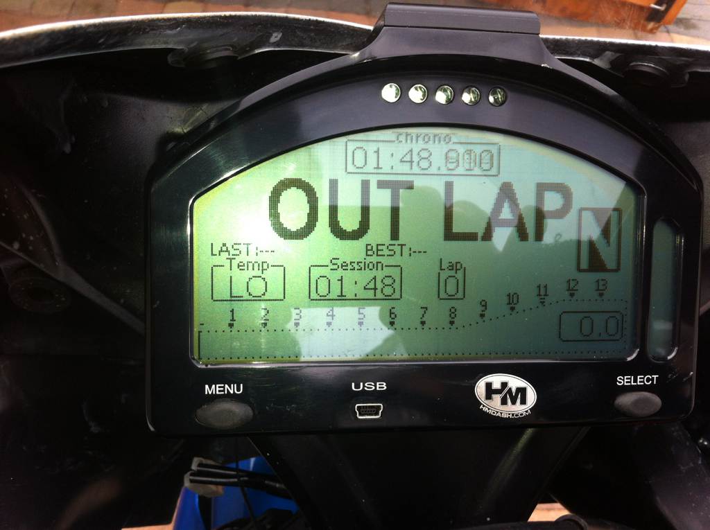

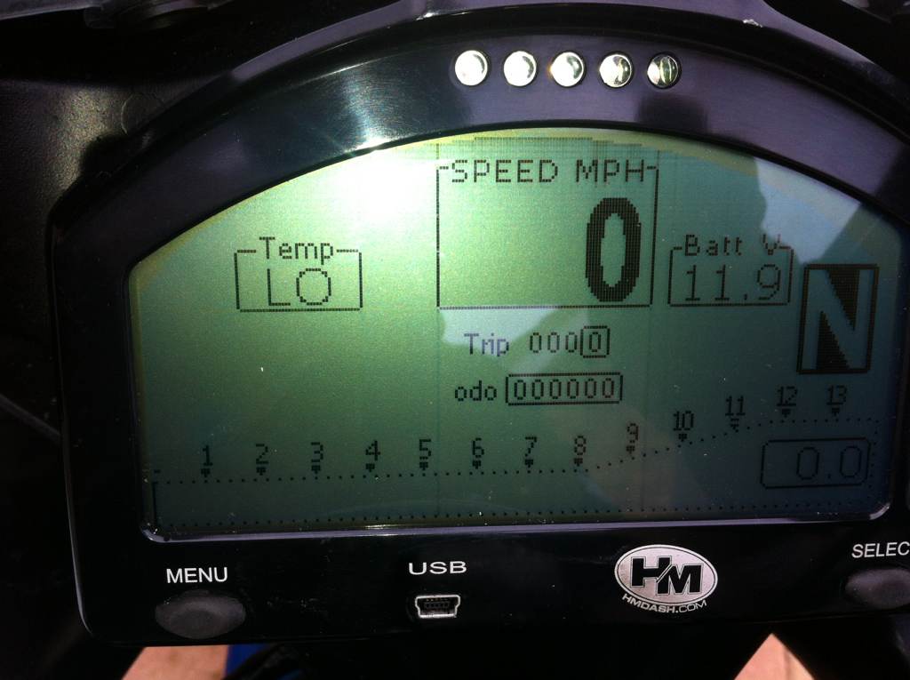

I know Colin.....just a bit of fun.....but without drifting off the subject......what a dash though !! Gps laptiming.....road and race modes.....predictive lap times.....records all you fav TV shows....ooops sorry that last bit was a bit of bull !!
Lol Youre proud as punch with that dash ain't you. I personally think it would look better on my SP. So if you are feeling charitable you could hand it over, so it can sit pride of place
well mate we ll get shot here.......but i will always be up for a straight swap.......that SP is my fav bike what a thread pal........glad you ditched the shiney swing arm !
Thanks. It really is 1 of those bikes that capture the soul. As soon as I seen and heard 1 for the first time I knew I would get 1 at some point. Amazing what a little change like the swingarm does to tidy it up. A couple of weeks and it will be back to tearing up the roads. I'll have to make do with a carbon surround around my clocks for just now.
Well Col we ve changed this thread to Colin and Rob suckering up to SPs and HM dash........i like the SP dash....but i admire all the effort to restore the beauty more.....im just a plug and play man myself......those Japs are bloody clever fitting every piece inch perfect.....so hats off for the strip and rebuild buddy ! anyhow thats enough...... im now off to tweak my quickshifter and map my PCV !!!!!!!!!!
