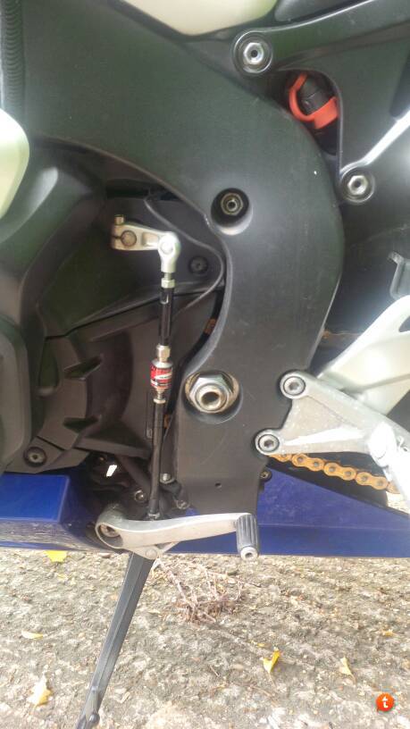

    I've just blagged a Dynojet QEM and push sensor for my baby for less than a bag 'o chips off fleabay but not getting the shift rod with it.
    This begs a couple of questions please...
    1 How do you "physically" mount the sensor? IE at the bottom of the (shortened) shift rod? or at the top?
    2 Where can I get said shift rod from? (apart from Dynojet directly) (or is that the only option?)
    and finally - is it just one rod I need? Dynojet website says "shift rod A" but contradicts itself on another part of the site which says it needs two rods.......
    If anyone has got or can take a picture of one fitted to their bike it would be a great help :D

    Your lucky, i am on the bike today, and on lunch.
    I'll go and get a picture for you. Bare with me a second!

    The sensor fits in between the two rods. Dynojet will be able to provide them for you.
