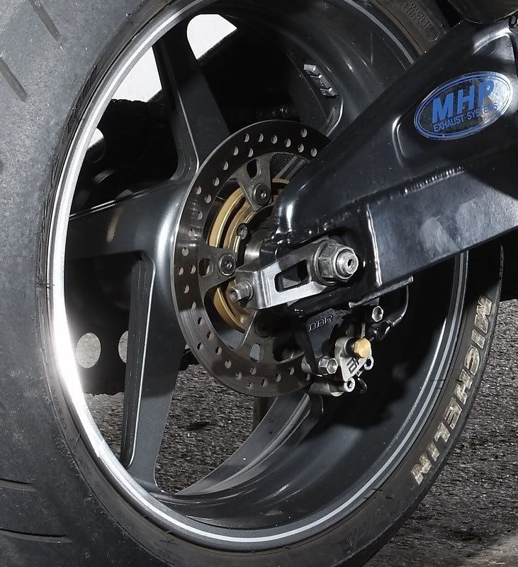

    Nice mate, shame you don't have those nice factory NISSINs too.....lol what that you need them... Whats the deal with that rear then mate?

    This is an early pic m8, we've gone thru the issues previously. I cant find any pics of your bike, where are they? Also, did you check out the new pics on my lift thread in maintenance, what you reckon?

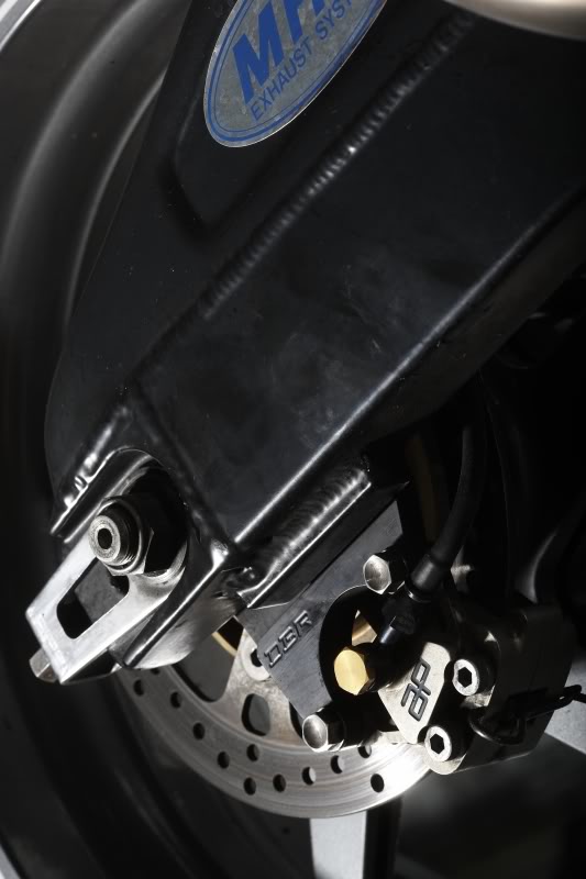

    Oh when you first fitted the caliper? I read the other day a chap had a problem with his caliper being too close to the disc with his BST wheels, same problem that you had by the looks of things, my guess is the BST's are set to the right as both of you had the same problem with two different brackets.. I have no new pics and the bikes in bits at the mo, soon as I get it together again I will take some new ones asap for you all... Bike looks very nice mate can't wait to see those forks fitted.

    Glad you like what I'm doing with her guys, thanks. Look forward to yr pics Arthur, sounds like its awesome from what comments I've read! Interesting what you said about BST offset, with the std setup, off set was spot on.
    As you can see by the unswept area, the Braking disc looks to be around 2.5mm oversize, which the Brembo nicely countered.

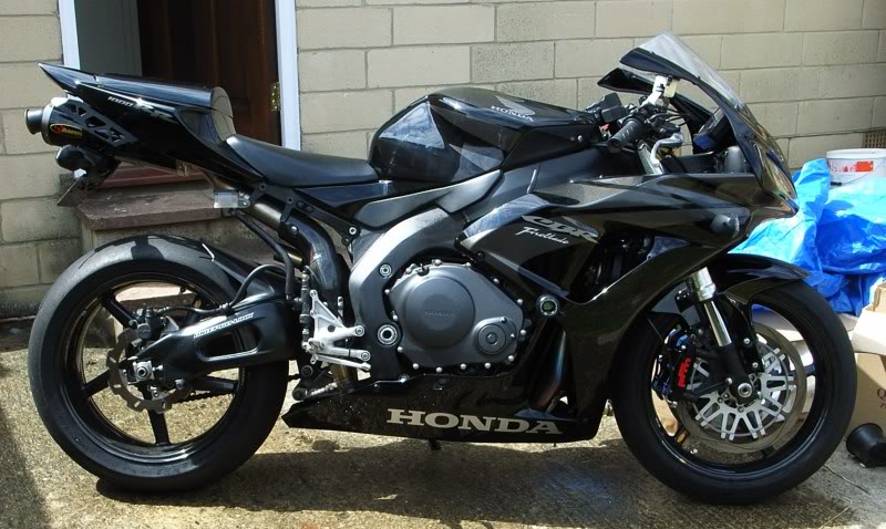

    I wish I had gone bespoke as on my Gixer, no such probs:

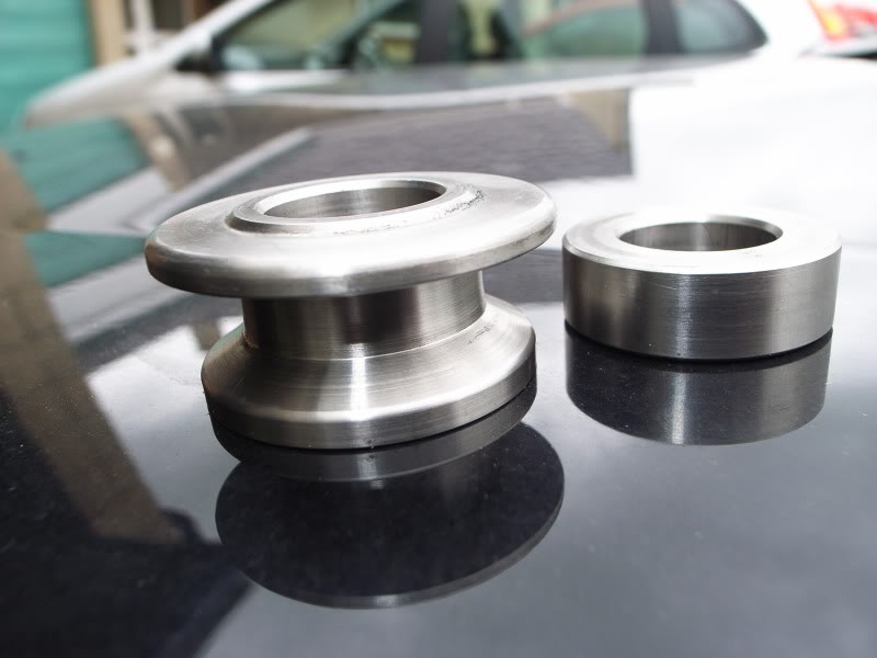

    I had to show these lovely spacers I had made in Ti by the boys at Pretech!

    Looks nice, so the Brembo mount runs 2.5mm lower than OEM, and the offset needed to be moved over to the right.. I am still waiting for my Brembo mount as the CZ one was a mile (8mm) off the edge of the Galfer disc so some of the pad was not used at all! Is your Braking disc bigger than 220mm? Sorry to ask so many questions mate hard to fine people who change from OEM.. and Im trying to guess what the Brembo mount will be like with my OZ wheels, by the way my offset on the OZ's is also more (+/- 2/3mm) to the right of the bike, however chain side is spot on seems that with aftermarket wheels the hub offset can be +/- whatever front and rear... :)

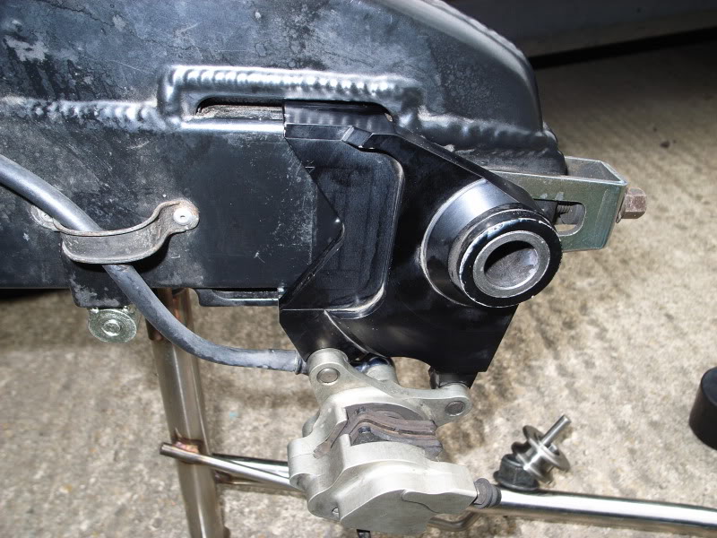

    Evo dude, that pic taken inside the swingarm looking at wheel side of captive caliper bracket, is that yours?

    It's my GSXR11 Craig. A mate turned my idea out for me 15
    yrs ago now.
