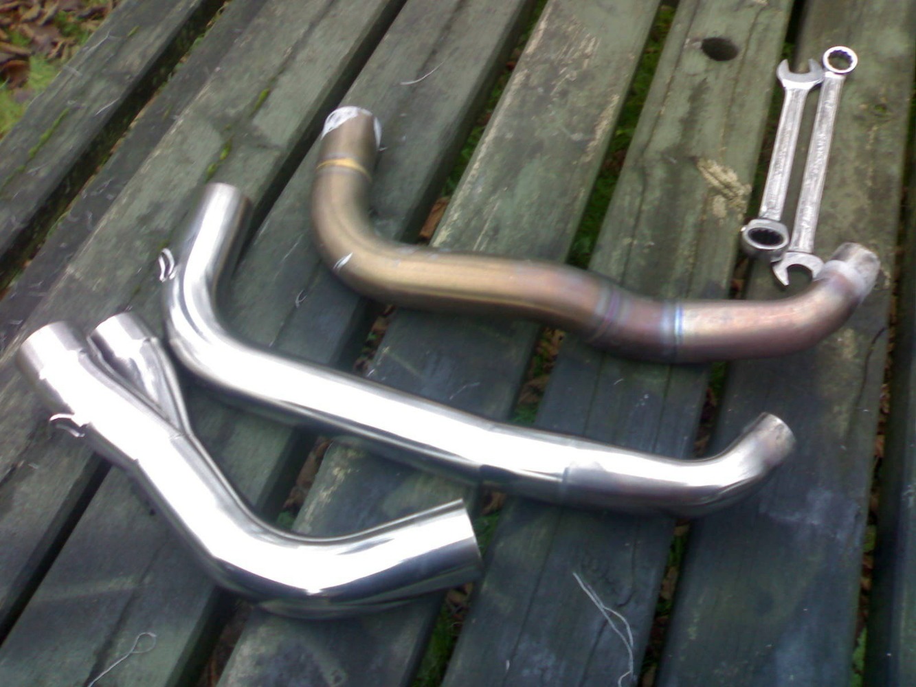

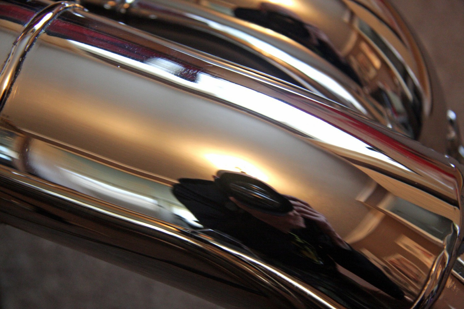

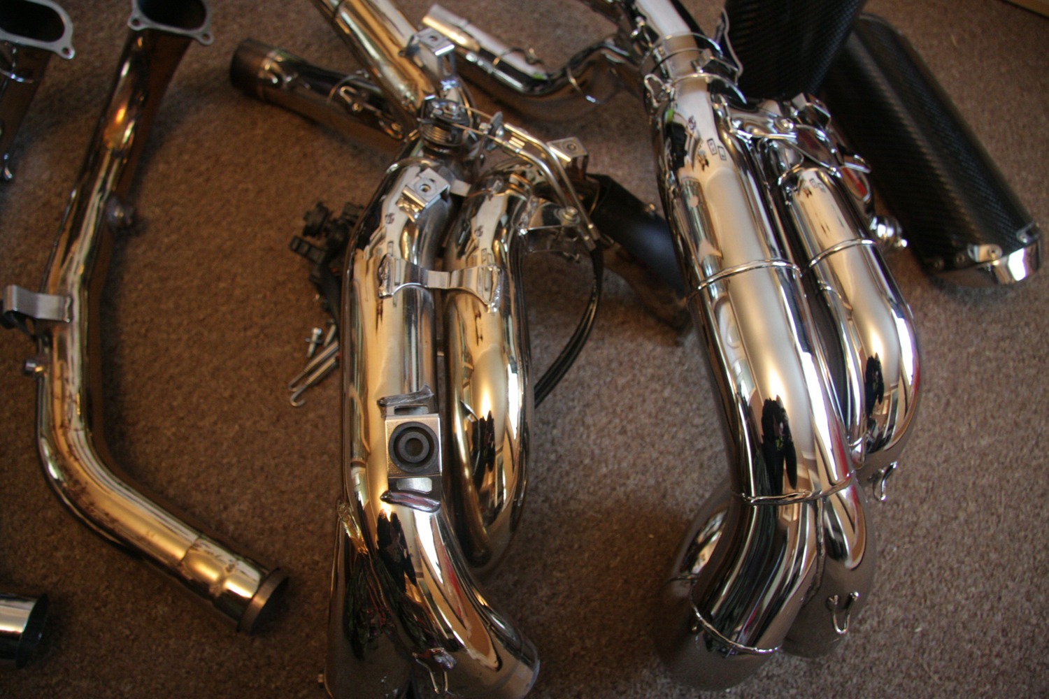

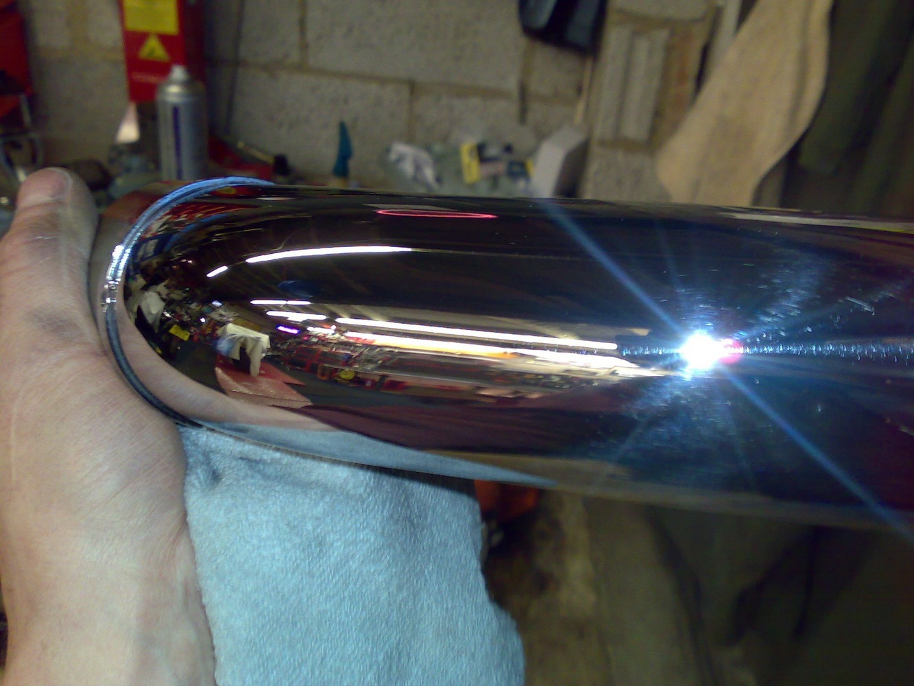

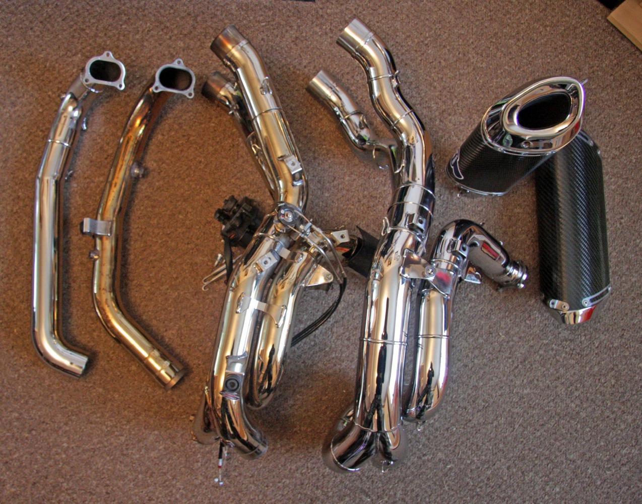

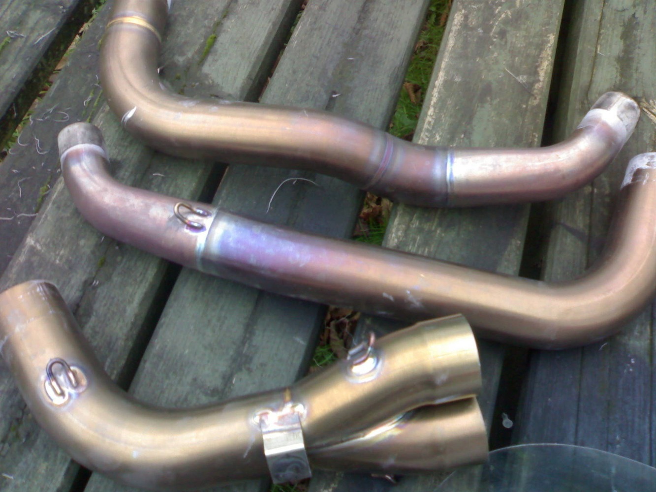

    Akrapovic don't use normal grade of steels or alloys they have there own foundry and make all the materials in house! you do in this case get what you pay for, they make the materials and all the tube!
    Materials
    They do talk of the types of steels but Ive read in depth from the akrapovic magazine that its a little like Mr Kipplings pies! I.e only they know what goes in! But in short for the most of us, a type of inox stainless steel with billet alloy flanges.
    :) you gotto love Igor Akrapovic, they don't mess around!
    Ive polished many Akra systems both Ti and SS, they polish like a mirror!

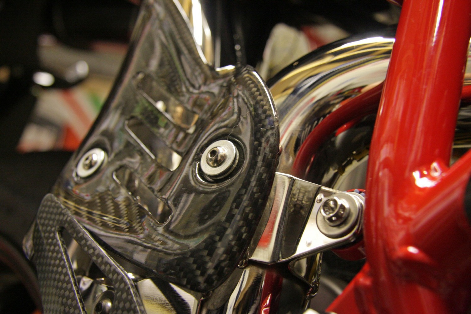

    Ti
    SS
    Did a Matt finish Termi last week..
    #6 arthurbikemad, Mar 19, 2013

  8. arthurbikemad
    5,371
    3,579
    Yep wax soaps and a mop, faster the better as it needs heat to melt the wax and release the compound onto the work, most normal drills etc dont have the power to create the heat, sadly I like the blue/factory look but people pay to have them shiny...lol It's not an easy job! Yes the stainless is easy to work with over Ti and you can get stainless like a mirror!
    Good hay, shame I HATE doing them...

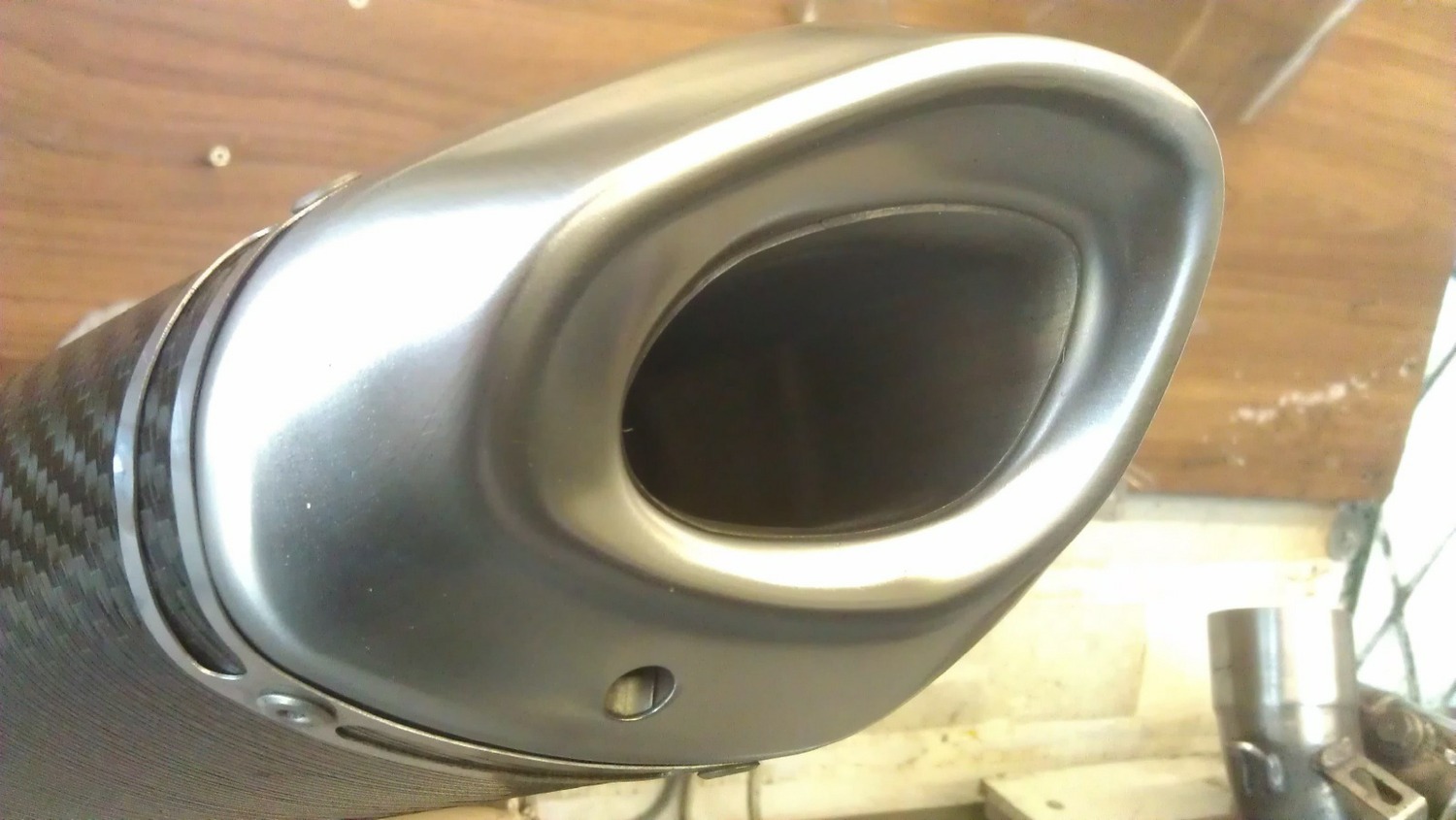

    Arthur, could i ask how you got a matt finish on the Termi end cap? I'm contemplating a full mirror finish or the matt finsih to match the titanium end can?
    Cheers
  12. arthurbikemad
    5,371
    3,579
    Satin lap mops mate.
