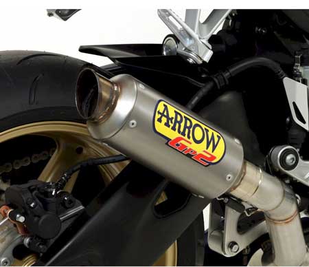

    Arrow on mine. Looks and sounds well.

    Asbo GP2... sorry, I mean Arrow GP2! :)

    Not that on mine, arrow titanium jobby

    Oh aye, the girl's one :p
