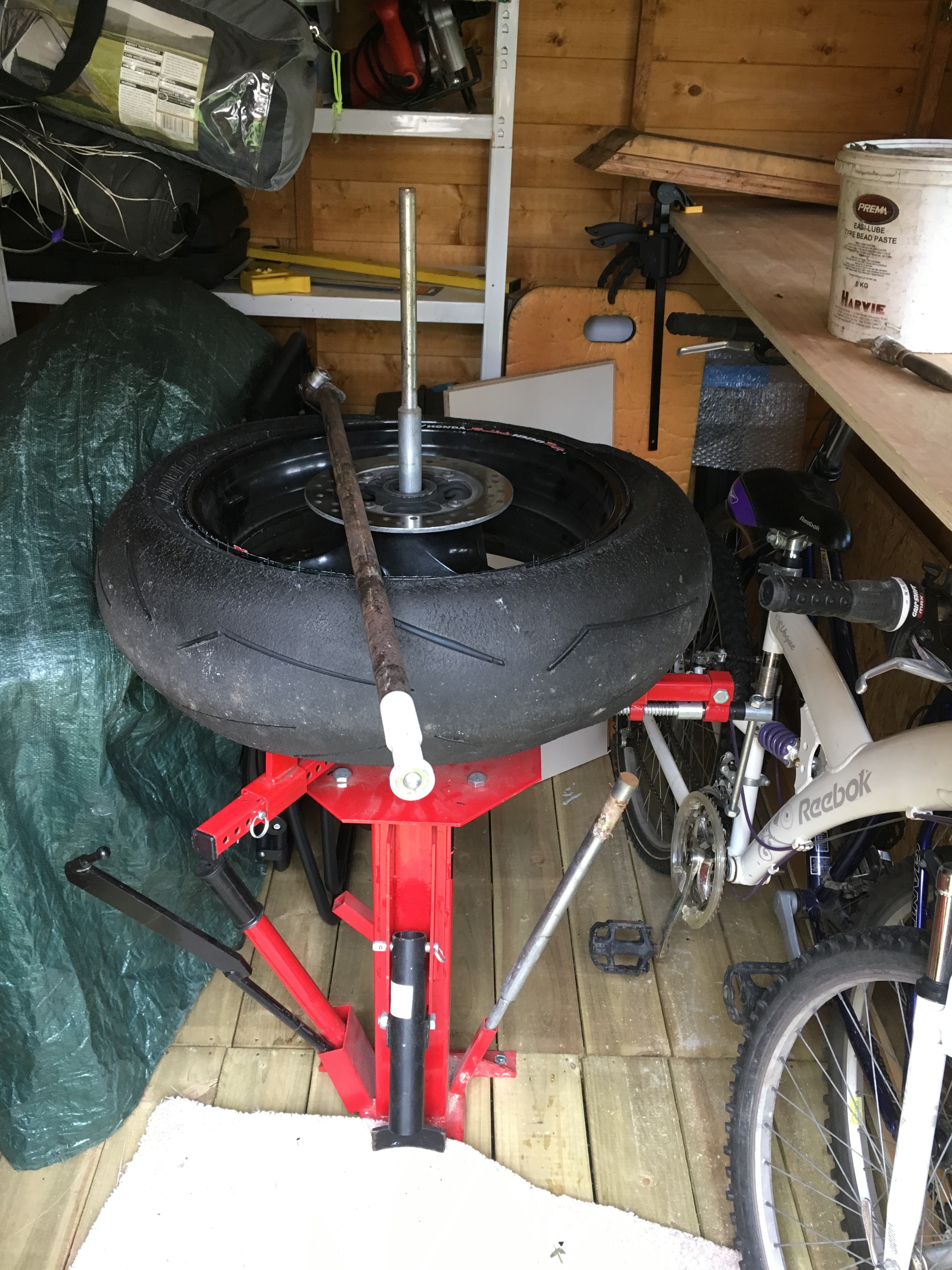

    I've just had a nightmare fitting a set of Metzler RoadTechs to my '07.
    My previous tyres were Michelin R5s and they went on like an old sock, dead easy.
    Anyone fit their own, got experiences, advise?

    I've got a MAX2H Evo2 tyre changer gadget. I don't think they're made anymore.
    It worked like a dream with the Michelins. The Metzelers, all together much harder. It was a warmish day, loads of tyre soap, tyres weren't cold, but just felt like they were too small.
    Anyway, there's a red dot on Metzelers. Their fitting manual says it's the lightest point on the circumference, so fit next to the valve.
    Well that theory doesn't work if your wheels aren't themselves balanced. I checked the front with just a valve, and it's heavy near the valve. But the rear, even with a valve, is heavy almost opposite the valve.
    My trial balance of both wheels suggests at least 50grames, which I think is ridiculous.
    I'm going to spin the tyres on the rim and see if it reduces. If it does, them the red dot is not the lightest point.
    If not, I'm not impressed with needing a row of weights stuck on.

    Learned a lot doing this. Having lost patience rotating them on the rim, I decided to inflate them and just accept the outcome.
    However, to my astonishment once the bead was seated both tyres now balanced to within 10grams.
    I'm at a loss to explain why they were both needing about 50grams when just sat on the rim unseated, yet blown up and seated went to near perfect.

    It's the centrifugal effect of the tyre not being round. If one part of the tyre bunches up then it sticks out more and pushes the weight further away from the centre of the wheel, meaning that you need to offset it on the opposite side.

    Yes, that's right, thinking about it. The tyre isn't equidistant from the rim until seated and inflated.
    Wasted hours messing with them.
