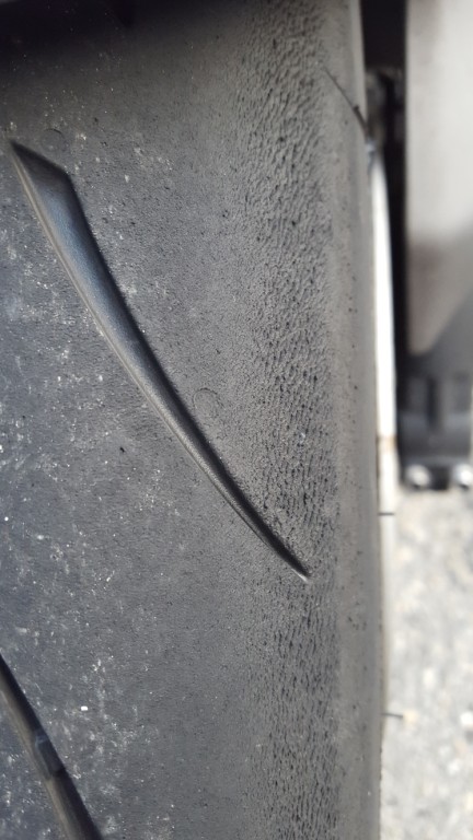

    So i ve finally put 2 10Nm in each leg.
    Hard to find the good front set up !
    I ve good sag with 8T preload / reb 10 / comp 12.
    But the front tire have a really strange wear .....
    The tire after 1000 miles of hard riding, first time i see it, is used like a " triangle "
    I will post a pic now, after around 1800 kms.
    The rear is wearing perfect, so the issue is from the front :
    I'm thinking is perhaps this tire which is like that but i find it strange.
  8. sinewave
    sinewave God Like
    8,134
    4,614
    Looks OK 2 me!

    As always, my front tire never shows this type of wear.
    And now its a little more used, i have an " edge / steps" on the lean edge of the tire which i'm not in confidence with big corner entry .
    Sorry hard to explain my feeling is your language lolls.
  10. Jimbo Vills
    It's more like the geometry of the front... It's ploughing the front.
    Raise the rear or drop the front should help it out.
    Mine was all over show, raised the rear and softened up the front and was fine.
    Here's my front after one q and 1 race :eek:
    That tyre was 30 mins old :(
