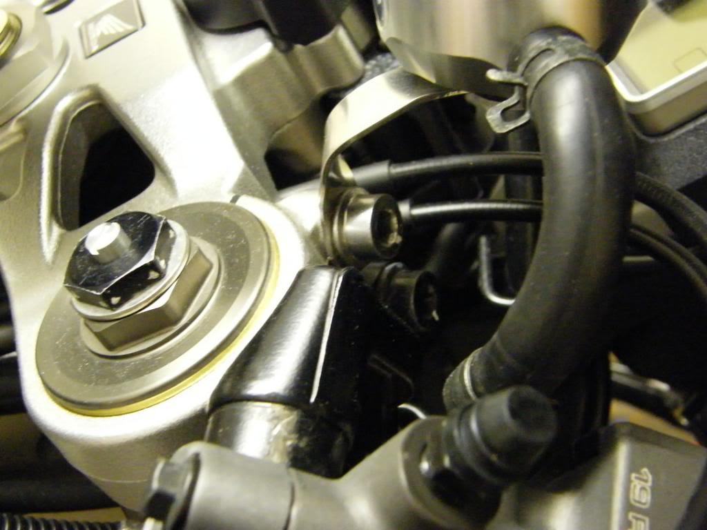

  7. ShinySideUp
    ShinySideUp Elite Member
    May 22, 2012
    2,100
    1,111
    For stock setup they should look something like this, where the end of fork tube is flush but the actual cap is about 3 mils higher than the yoke.
