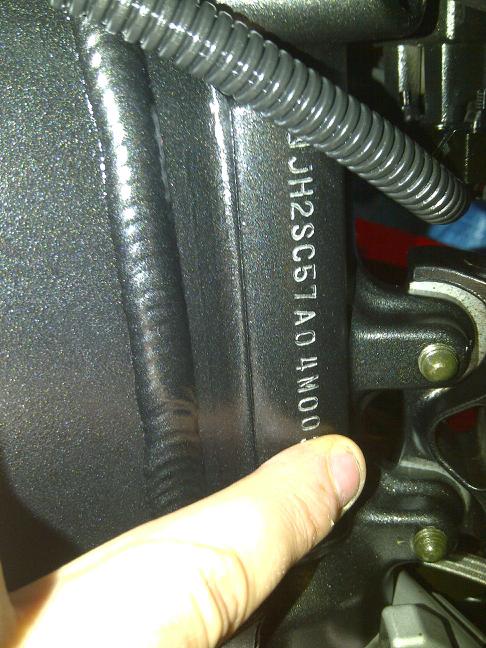

    My 2005 CBR1000RR was supplied by a reputable shop to the previous owner as a track day bike that had been built from an insurance write-off doner machine, six years ago.
    Having recently purchased the bike, I'm now going over it to make it ready for next year and I thought I'd look into it's history.
    My first idea was to carry out a hpi check onthe frame number to see what I could find out.
    This drew a blank as there are only 16 digits and there shoudl be 17. I then went to DVLA and asked them what they could tell me, they also said they couldn't help as there are only 16 digits.
    I have all the receipts etc from the original sale and I have no real need to find out the history, but I am curious.
    Has the number been 'doctored', has Honda ever made frames with only 16 digits (maybe for oter countries), or is there some other more sinister reason?
    If anyone has a 2004/20005 bike, could you compare my number with yours and let me know if it looks similar.
    I have erased the last four numbers (for obvious reasons.)
    Any thoughts are welcome.
    Pete

    looks like your missing the "a" for model number sca57

    the sc57 is the model ie cbr1000rr
    then the next is check digits ie A3 so as
    for as I know a letter is missing after the sc75 and
    before the 3...what it is thats missing I couldnt say.
    could it be a grey import?

    is it my eyes phantom or is there a step atfer the "c"
  8. phantom
    phantom Active Member
    Jul 21, 2012
    4,905
    1,470
    I thought that too but I have seen a step on a gixer frame before so I wouldn't look into it too much

    It would be a great help if someone with a 2004 to 2006 CBR would taske a quick look to see if/how their number is different.
    Doing the VIN checker and inserting an A after the SC57 doesn't work, but inserting a 3 comes back as correct. Could it be SC573

    the 4 is the year and the m is plant that the bike was made. between the sc57 and the 4 is the check digits ...this is where the problem is by the look of it.

    Mines a 2004 but hope it helps, does look different to yours though.

    I was told that mine is a 2005 model (although the 4 indicates that it was made in 2004.) It certainly looks very different from the one pictured above!

    Thanks for the help Joe. From what I can make out; 'if' the number is correct, there should be a check number before the 4M. There's a pre-set way to work out the check number substituting numerical values for the letters in the sequence, then multiplying them and then dividing by 11. (I haven't made that up, honest!)
    Using this formula with my number, the check number comes out at number two. Unfortunately, even inserting a number two in the right place isn't helping check the bike's history. Every check I can do comes up as number not found.
    I'm wondering if it's either got a dodgy past or if it's been imported from abroad and there's no UK records for it.
