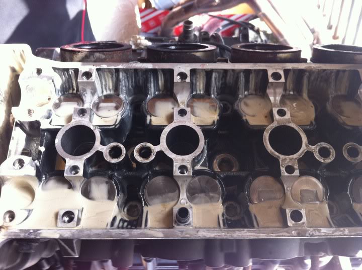

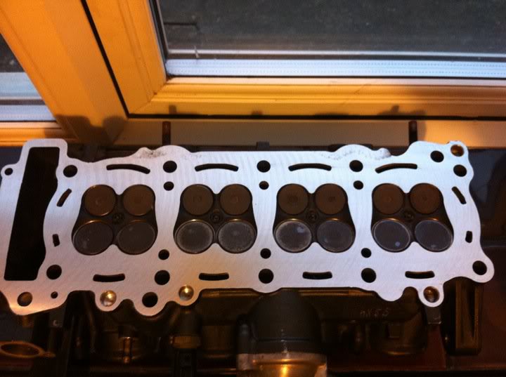

    My R6 had exactly the same symptoms, in the end it was the head cracked in the water jacket, a pic of what the internals looked like.
    Bottom one is the new head i bought, .5 thou skim, kit gasket, lapped the valves in, minter.

    O no milky is bad bet one was gutted? pld for getting your hand dirty mate bet it was a good job?
    But really you had the same symtoms ie missing and shit untill norm temp then it ran on all four but smoked a bit and was under powered that sound weird for a HG fault!!

    Was a minter of a job, motor was filled.
    Basic story, took said R6 in px, ran fine on delivery, stripped bodywork off, let it run up outside the workshop, all of a sudden it starts sounding like a triumph bloody triple, killed the engine straight out, checked dipstick and weyhooooo its like popping a champagne cork.
    Worst part of it all was manually lapping in all valves, they are ti valves so you have to take great bloody care.
    crack was right underneath a cam mounting bridge, bastard to find.
    id say its a top end issue on this blade, but i wouldnt rule out the possibility of a HG problem.

    Is a quick test to check the coolant for gasses..why not... Nasty head that cc.
