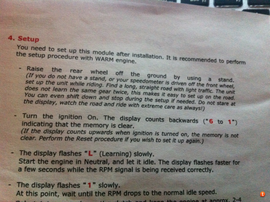

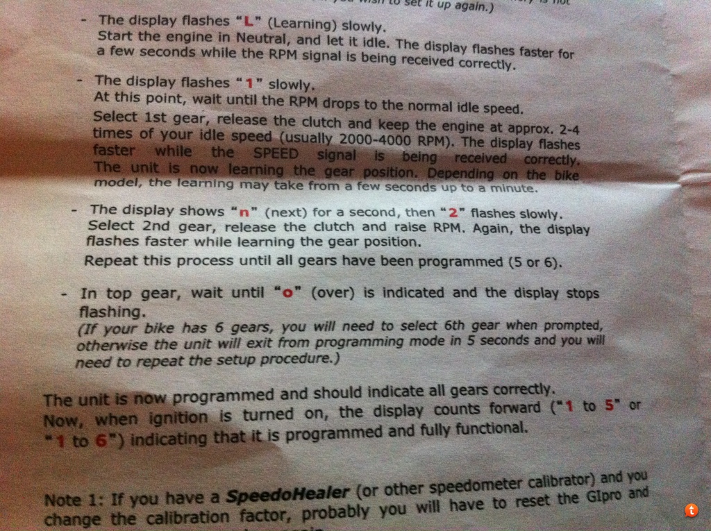

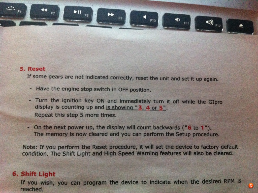

    I think you need to clear it first, then in the learning (L ) position and thenfirst, rev up to 4000 and it will blink faster and go to 2nd and so on
    If I can remember correctly 5 or 6 times the kill switch on off, something like on 1, 2, 3, off, on 1, 2, 3, off, on 1, 2, 3, off, on 1, 2, 3, off, on 1, 2, 3, off the back on then put it into the L
    if not shoot me a pm in about an hour and will have a look when home, should still have the instructions in the garage from the R6

    here is how to reset it
    her is how to install it
    this is for the x type, but knowing gipro it'll still be te same set up

    knew it was something to do with 1, 2, 3, 4 :D :D
    if it doesn't work send me your email address and I'll scan all the pages in for you

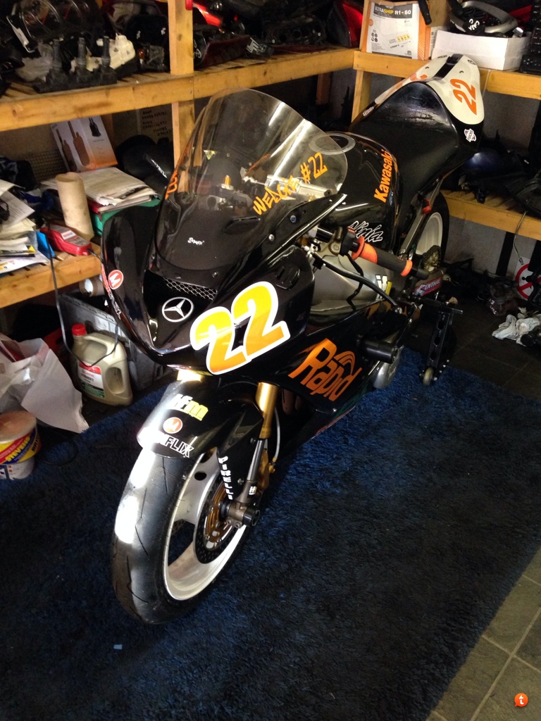

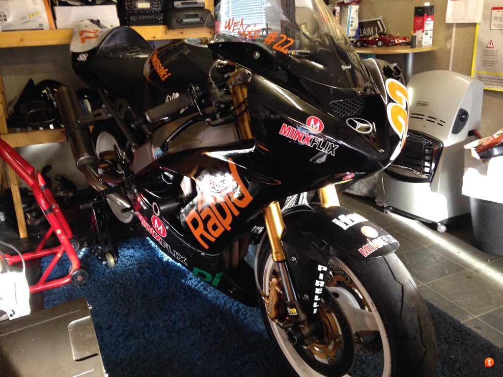

    Alright alright lol and I had to cut a notch in sprocket cover as now race shift right old day today but ready for brands with my spare panels on [​IMG]
