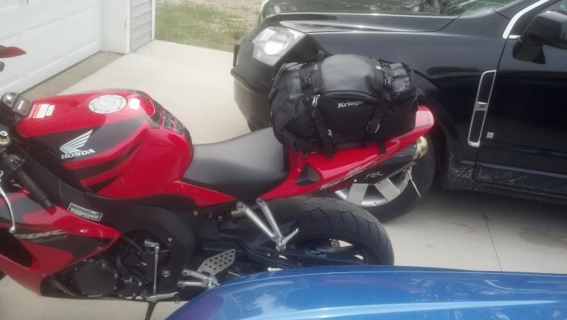

    Thanks for the info, still a little concerned about the panniers rubbing on the tail section so went with Kriega US20 in the end.
    Example below...

    Great kit the Kriega. Highly recommended. Good choice
  13. Jimbo Vills
    Kriega is awesome (I use only this) but be careful.... Can be a fucker on ya paint.
    And the rubber mat stuff even worse folk use as 'protection'... Specially when wet and covered in grit.... Sliding around
    Rentec rail and kreiga best option I've seen as blade seat bends under load and rack stops this and protects.
    Never an issue on the r1... Used to just put electrical tape over rear end and that's was fine.... Plus the straps fit to the subframe braces - again not an option on blade.
    Don't! I repeat.... Don't! Put gaffa tape on an after market paint job. Take the lacquer straight off that will after two weeks solid on there lol :eek::eek::eek::(:mad:
