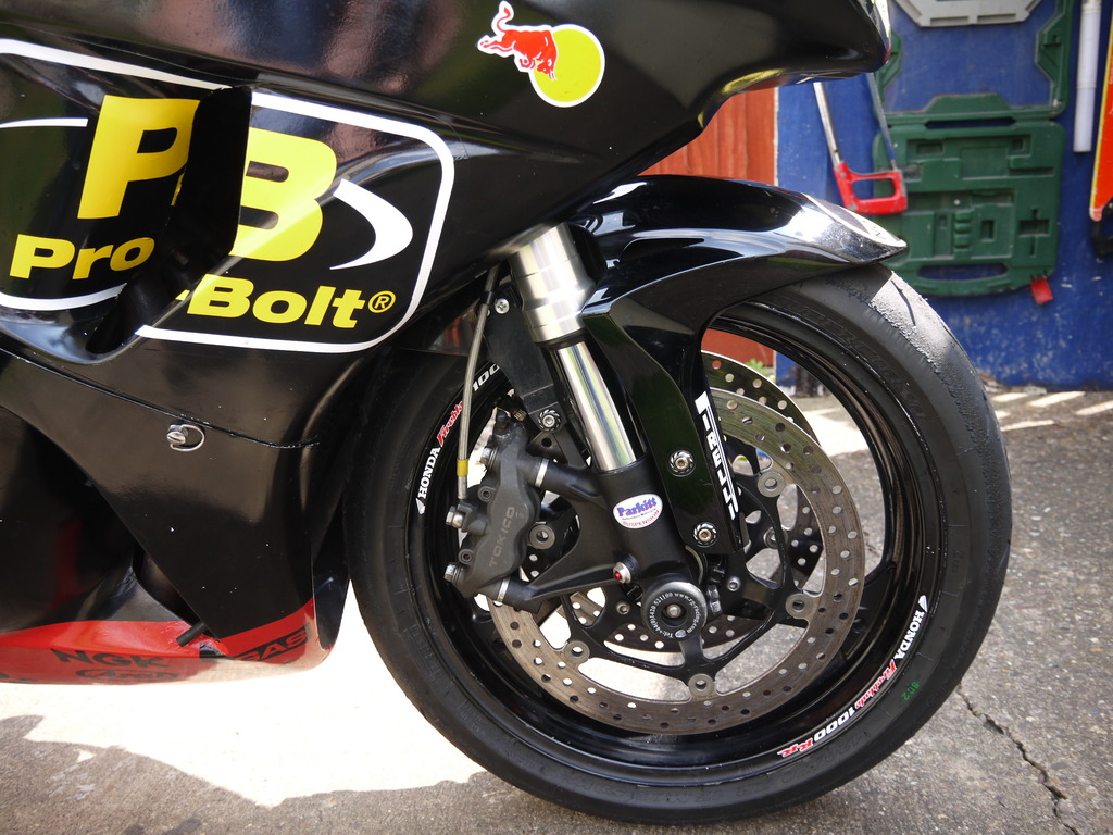

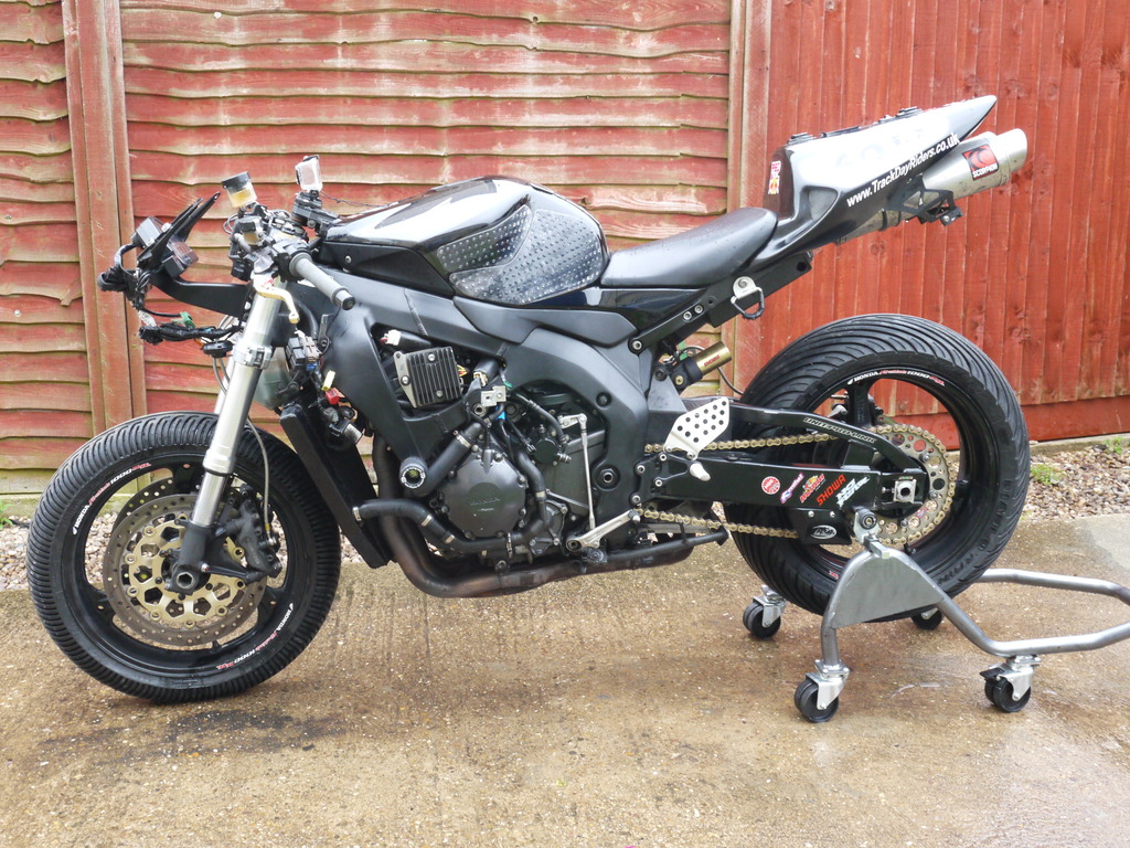

  4. Muffking
    5,836
    2,831
    My bike is buried at the back of my garage over winter, but if you can see by the following pictures that I have my hoses cable tied to the top O/S fork and then P-clipped to both sides of the front hugger before they reach the calipers.
