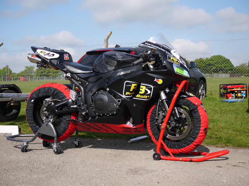

    Very similar to the one I've got and clears the horn ok (road legal track bike).
    Slightly better view here.

    Thanks for the pics and info. With the stand I have, it looks like the end of the bar will be in contact with the lip around recessed section at the hole in the headstock. Would have preferred more contact on the flat surface around the hole. This is all pie in the sky till I get the rear bobbins delivered. Was just offering the stand up to the bike to see if I think it going to do the job. Back to work for a few days now so will try it in anger when I'm off.

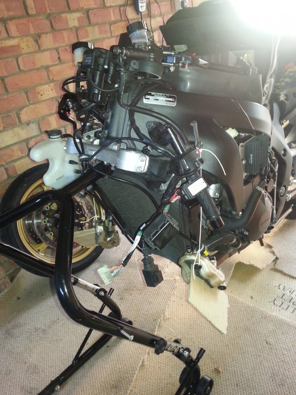

    If it helps, here's a pic of my bike on the headstock stand.
    FrontEndStripped
    by GappySmeg on 1000RR - The CBR1000RR Fireblade Forum
