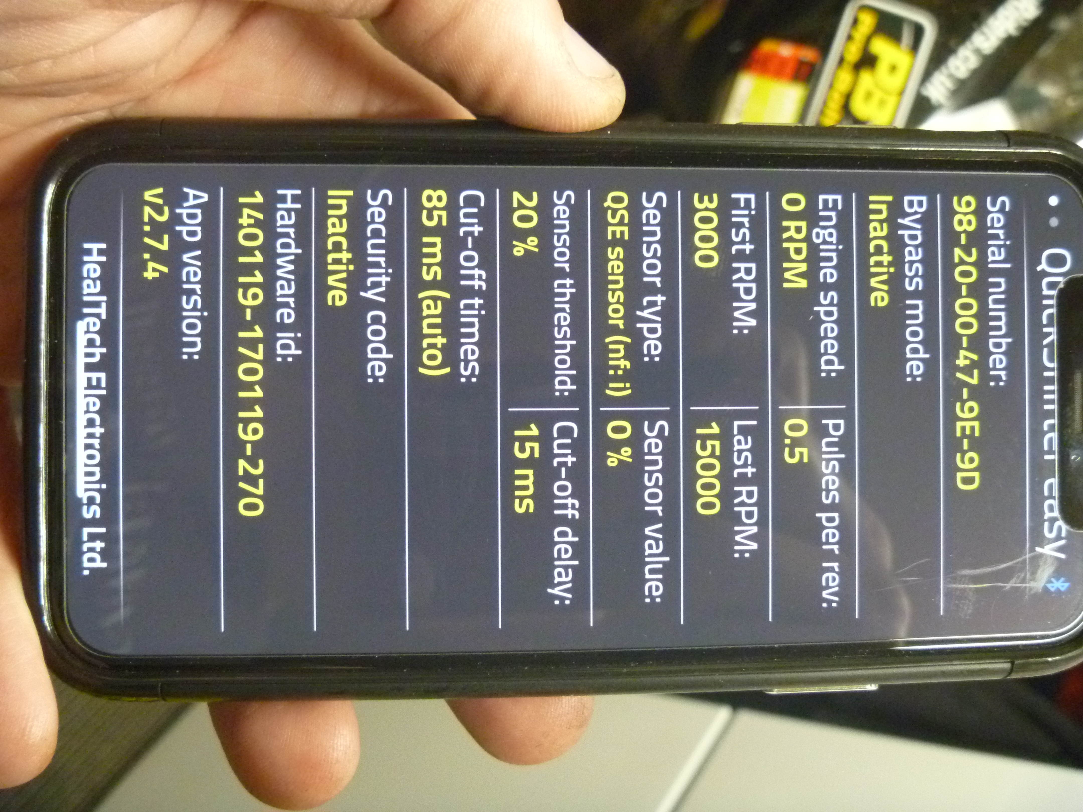

    These were for our zx7rr race bike and they worked really well for my son.

    If it cuts the ignition but doesn't change gear then the cutoff time is to short.
    This was my setup for the RR6 track bike.

    We only used the expert mode.
