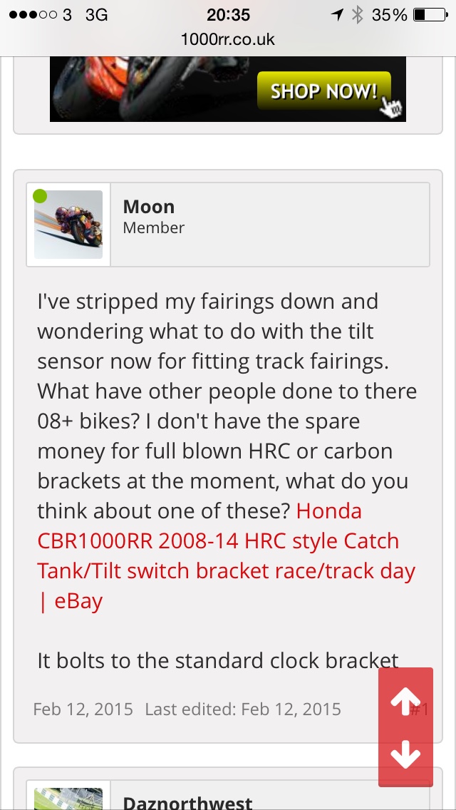

    I just done a bit of stalking investigation and found this post from moon.
    Do you have a picture of how it fit and looked dude as I think that's what I'm going to get. [​IMG]

  10. Moon
    Moon Active Member
    Aug 9, 2014
    433
    102
