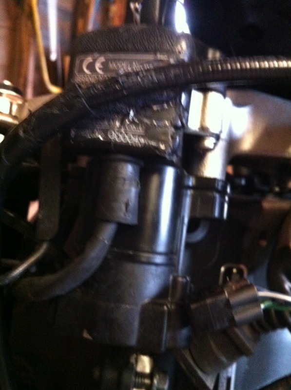

  8. broos3
    broos3 Active Member
    Apr 14, 2011
    160
    19
