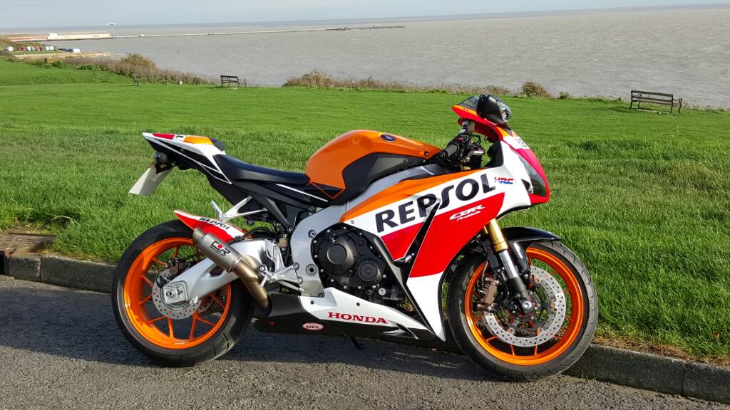

Hi bit of a random one but does anyone know the length of the exhaust silencer on the bsb Hondas ? I don't take delivery of mine for a few weeks so can't even try to scale it. Cheers.
A new blade nothing as exotic as a bsb bike I just want to replicate the look of the bsb bike exhaust.
Foenix used an ARATA full titanium system with AKRAPOVIC carbon can from an RSV4. Its longer than the one used by the bsb team but gives an idea,
Thanks for that si not so keen on the look of Phoenix's set up I've got a short akro can and with a bit of help from Mark Hill I might get somewhere near the bsb look.
To replicate the bsb system you'd need to get a titanium pipe fabricated to match either the standard headers or buy akrapovic titianium headers and matched to that, however be aware that the standard and akrapovic headers exit in different positions so any link pipe you get made will only fit one type of headers
To Have the BSB looks, you have to bought Brock's Full Ti exhaust and put in a a short ( 300mm ) Akra can 60 mm diameter. and you got it.
