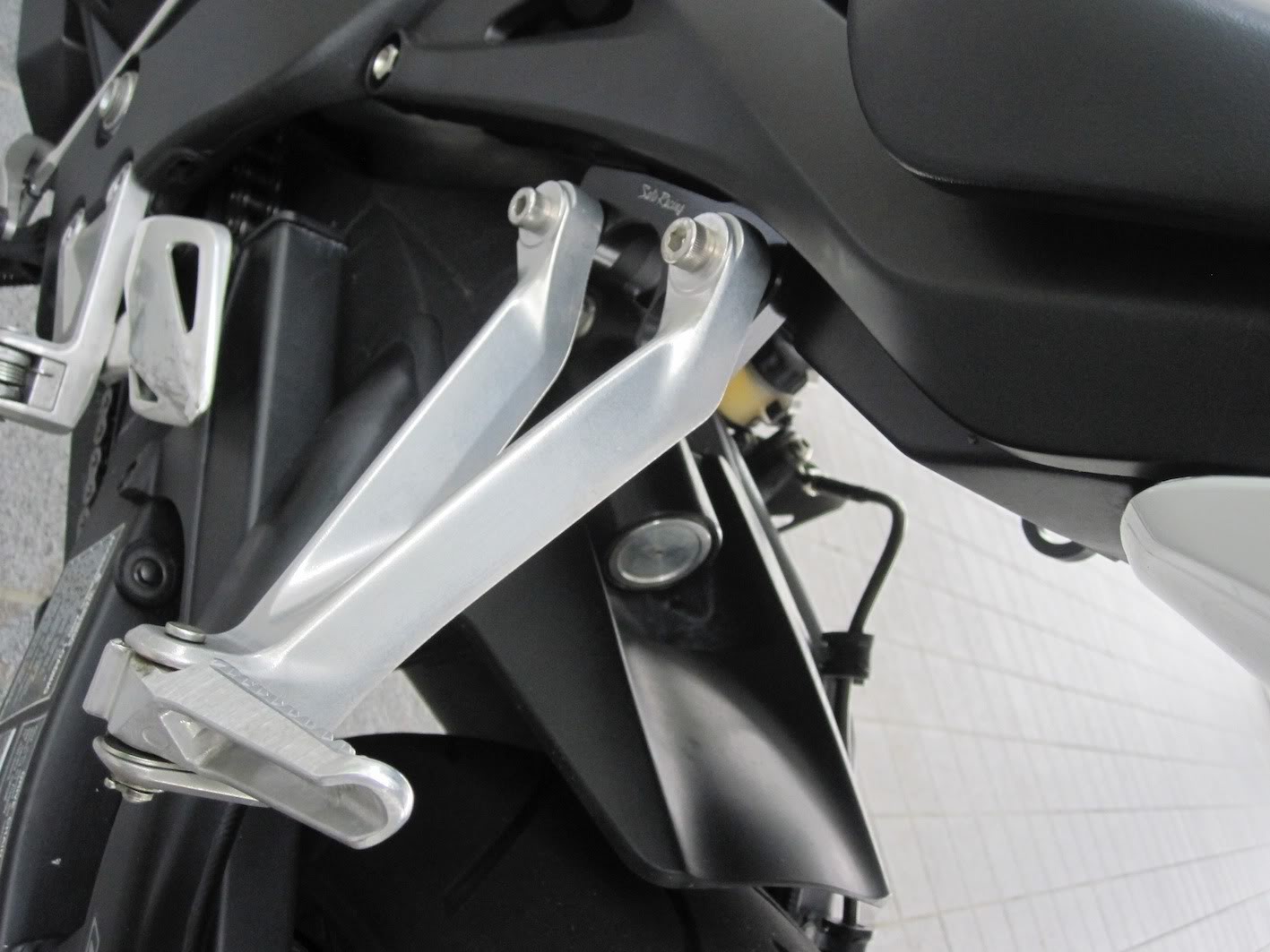

    I've had a look a couple of times now at removing the pillion pegs but each time I think surely it can't b that hard. Surely?

    Jeez it does look as bad as I thought it would b. Not looking forward to this at all. I think I'll leave that till it's hibernation time then.

    I did mine mine last week the time is realising you have gotta remove the lot it's easy enough but Jesus on the GSXR it takes 1-2 minutes tops lol Honda do make em well

    It really is an afternoon job then. I'm going to wait till I put the bike away for the winter n do it then. I've got a powercomander and LED lights to fit anyway, so may aswell do it all at once. I can see myself making those hooks.

    Everyone complains about this and the fairing removal, but the point is Honda designed this stuff to have no visible fasteners on the outside so the bike looks clean, minimal and simple. That's why it's different to a GSXR/ZX/R1.

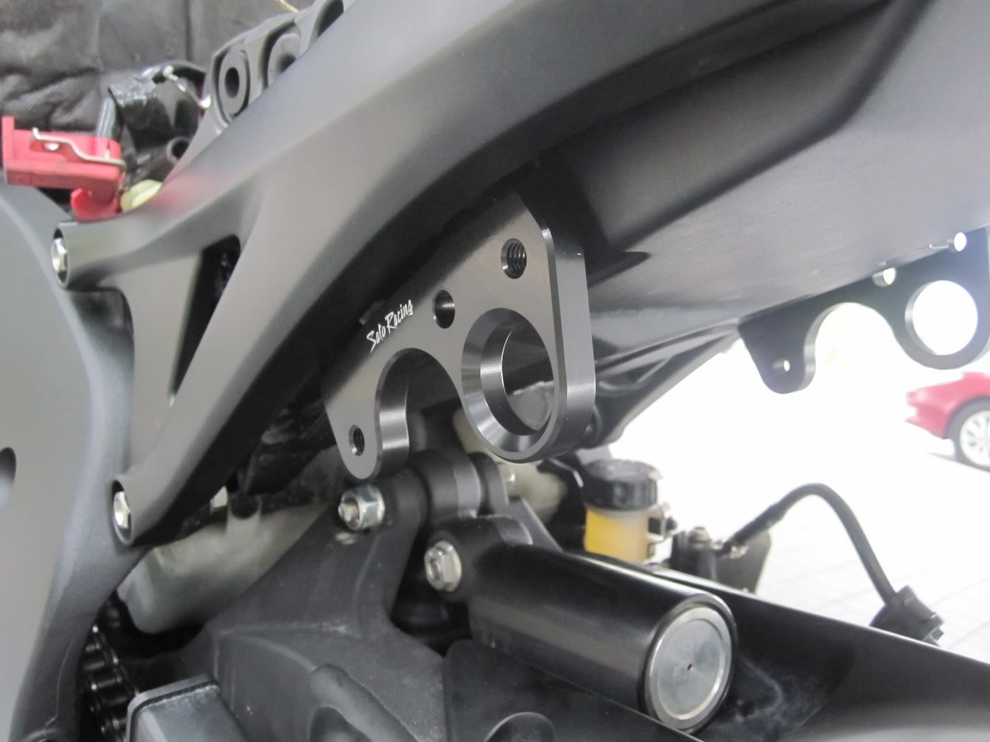

    get a offset screwdriver from halfords bout 3 quid and cut the flat end bit off with a dremel a real help so you dont have to pull all the tank of and battery tray :D can just pull it up a little

    I didn't have to do any of that anyway . Stripped the back , Split the subframe and removed each side 1 by 1 to unscrew the pegs

    Take rear end plastics and seat lock off take battery out and pull a resistors off etc, make sure all fasteners holding the tray in are loose then slip it up out and backwards but not completely, just twist it 90 degrees remove one then the opposite way to remove the other I did have to un bolt the tank to get at all the fasteners though, I'd say if I had to do it now I know how to I could do it in 60-90 minutes tops
