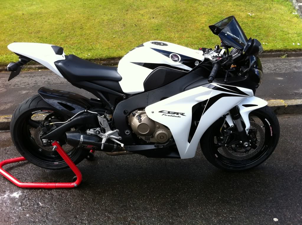

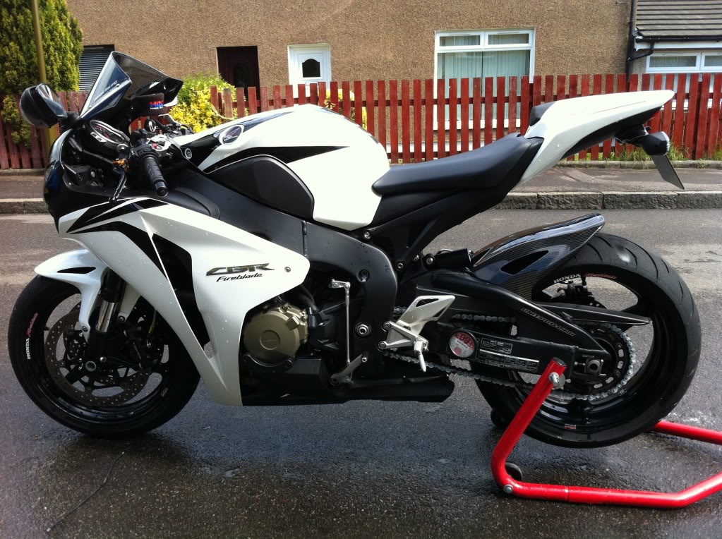

    my bike
    #15 davy19, Jun 15, 2011
