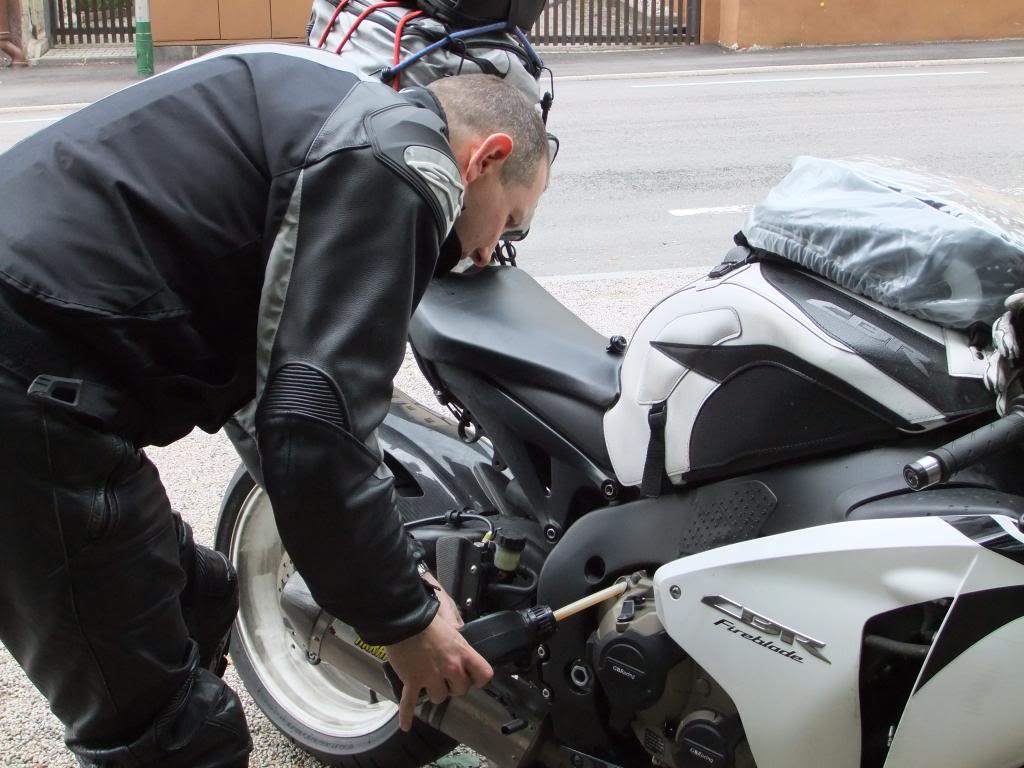

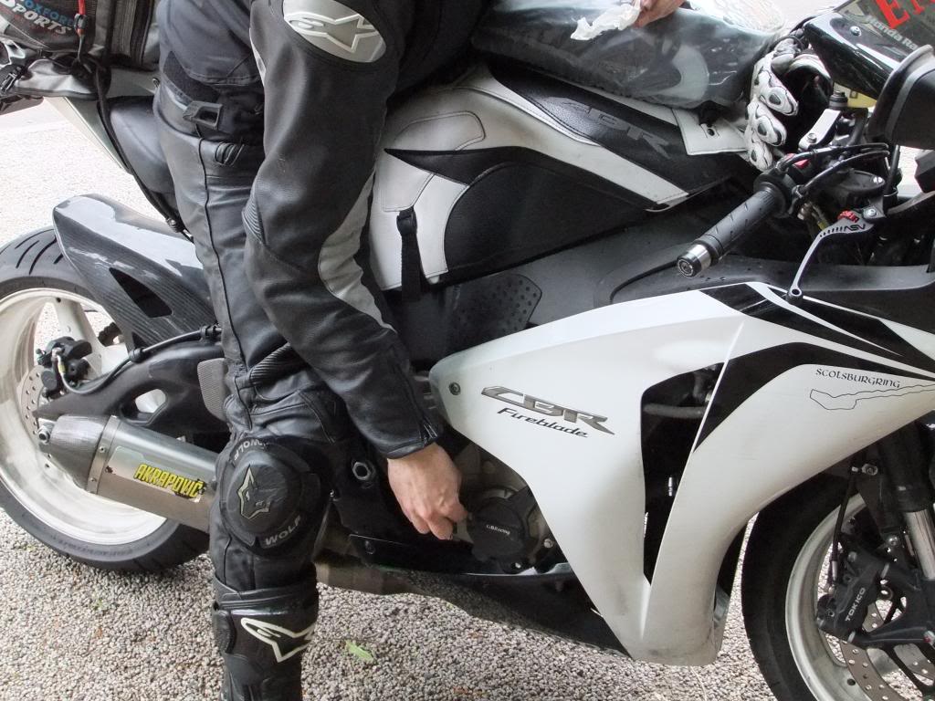

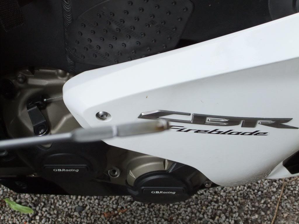

    No.1 - Checking oil is easy when sat on bike as below:
    No.2 - If oil level is low (as per this pic which annoyingly my mate took and focused on the fairing not dip stick) you buy some oil
    No.3 - You pour in some oil and check level
    No.4 - If going on a long trip, carry an extra litre (and early Blackberry cameras were rubbish!)
    After 80k I've checked mine a few times...
