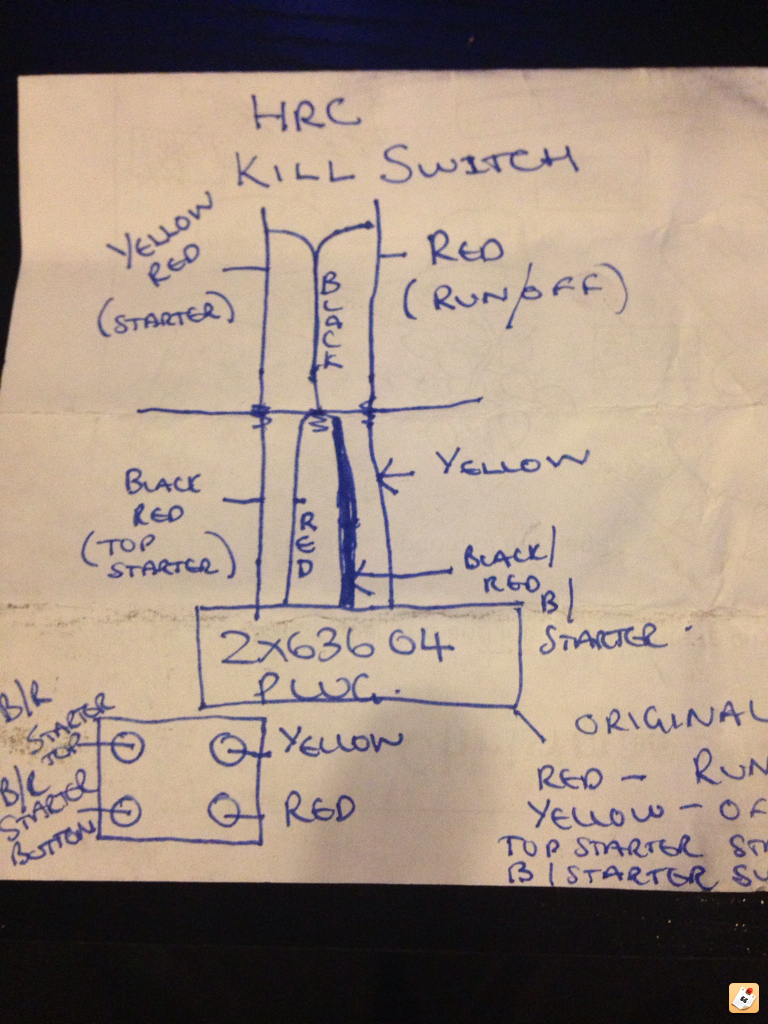

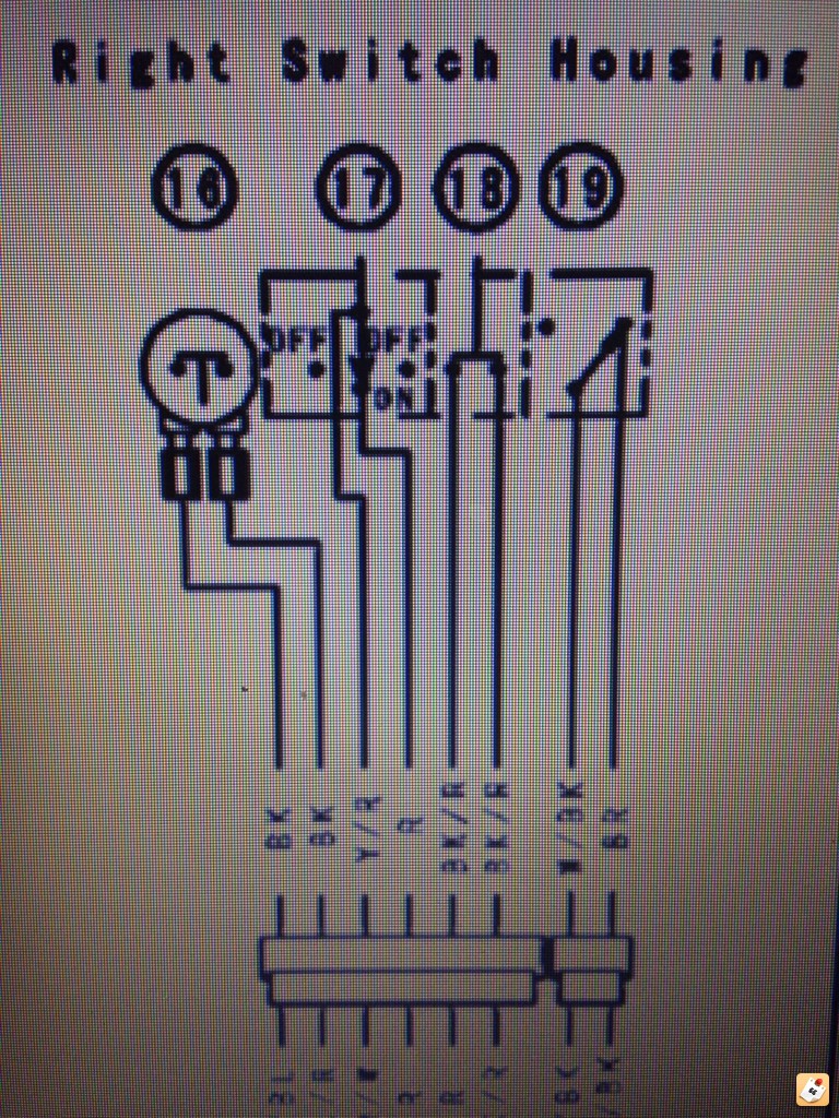

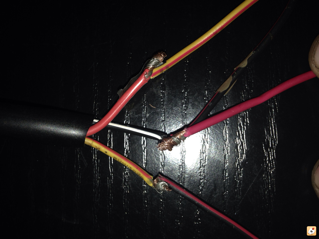

Right I'm a complete div when it comes to wiring but I have gave it a go and I'm close I'll try to discribe best to my ability . Wiring won't be staying like this it will all be soldered and covered . Piss taking welcomed after help ha ha . I now have the switch working as wired so I can turn key hit starter away she goes press stop on kill it kills the engine . But if I switch back to run nothing boots up like power commander fuel pump until I press starter it boots and starts up . I can turn key on off boots normally . Hope this makes sense . The Hrc has 3 wires Red runs to top off/run Yellow runs to starter push Black wire splits between them both The zx6r had 4 wires grrrrrr Red was run on top switch Yellow was stop on top switch Black / red wire run to starter in Black /red wire run to start push out . I think I have a starter wire black/red in the wrong place I will just go to work tommrrow and have a play Right my wiring diagrams lol (lamb chops if you need a hand with your loom giz a bell )

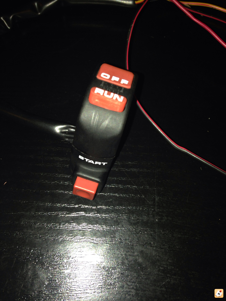

I have just took switch apart a bit so yellow is starter button pushed in and black is out . So I'd say run is red and black is off kill I can't get this part of switch out
