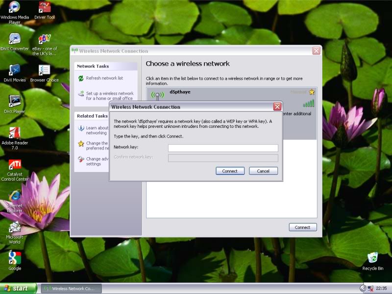

    I,m trying to set up a lappy after doing a re-install of windows XP.............managed to install the drivers for the wireless bit but I,ve hit a brick wall as I can see my connection,its good,tried to connect but all its doing is "Aquiring Network address"! and not connecting?,it keeps asking me for a WEP number/code or WAN??? WTF is that all about?
    As you can tell I have limited putor know how so if anyone can shed some light on the subject would be great!
    My wireless router is an N+Belkin type.

    Tried the numbers on the base......no joy.
    Theres a WAN MAC number
    A serial number
    PIN code number
    LAN/WLAN MAC number?
    There must be a better way of doing this!!

    you could try logging onto the router if you have another pc connected.
    If you have, try the following:
    1. open your web browser.
    2. in the address bar type 192.168.0.1. If nothing happens try 192.168.1.1
    3. this should bring up the router logon screen asking for username and password. Unless they have been changed they are usually "admin" for both. If not try admin for username and "password" for password.
    If this gets you in, go to the wireless section and you should see the WEP key.

    Thanks guys.................sorted......................I found the original disc for the Belkin router,installed and then headed for the spec bit............yep there it was.
