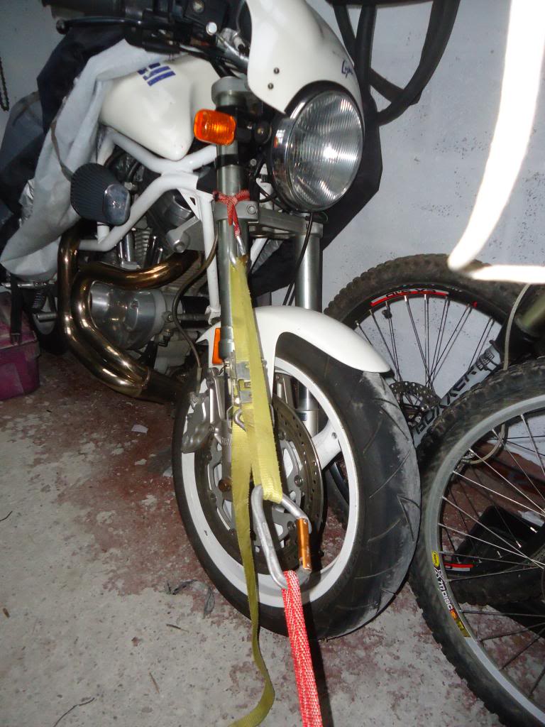

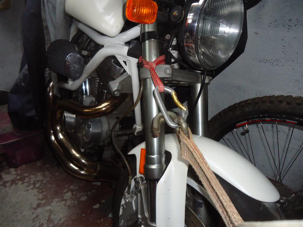

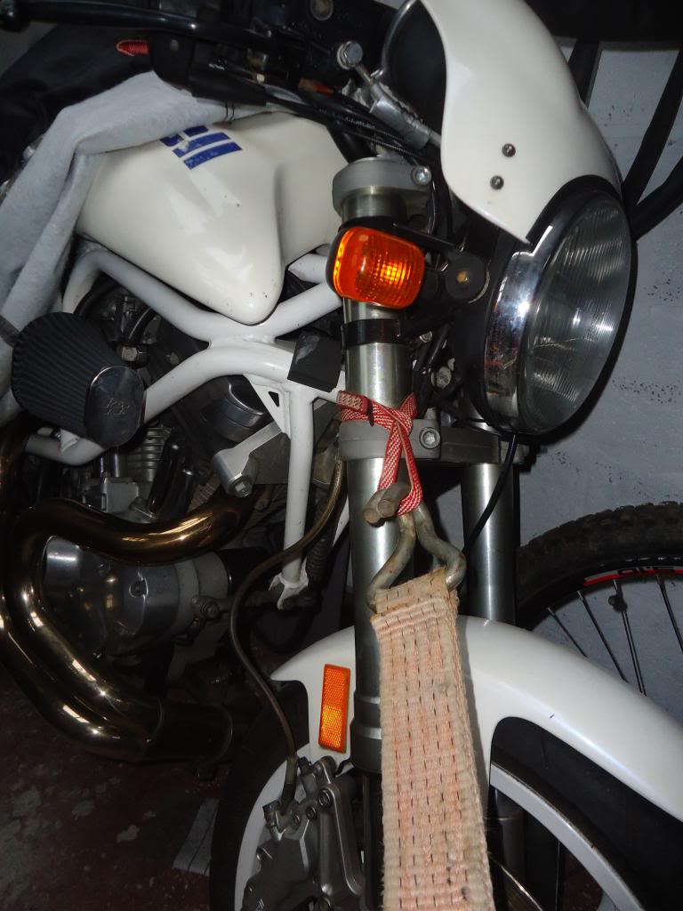

    I would hate this to happen to any of you so PLEASE use a karibener or screw up shackles between the ring and triangular loop formed by the the ratchet hook as this will not allow the hook to disenguage. Better still use climbing slings larks footed to sub frame or fork yokes. Off to shed to photo what I'm talking about. Could someone post sinewaves pic here as I dont know how, thanks

    The suspension bounce can allow the hook to come free when slack
    With the karibener through triangular bit of hook it cant release
    Better still remove the hooks by unbolting them from ratchet mech to form a loop ratchet strap and use karibener and sling at both ends. Bomb proof idiot proof and easy to adjust remove and no risk of scatching and also norisk of metal on metal fatigue.
