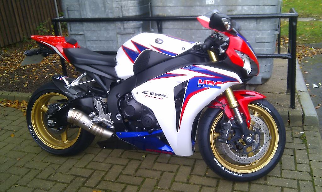

    I've got the LV on my 2011 Repsol. It was OK without the PCV but it's so much better with one fitted. After a session on the dyno and a custom map it's even better. Gets rid of the stuttering around 3K to 4K revs range. It's also worth blocking off the PAIR pipe while you are fitting the PCV to stop the popping when you shut the throttle. That is assuming you get a PCV and you don't like the popping LOL. Forgot to mention I run mine with the bigger baffle fitted it's still bloody loud and would fail the noise test at most track days.
    Steve

    Thanks for that extensive reply, it's good to know it won't adversely affect fuelling/performance. Looks great on your repsol. Great paint job:D

    I think it looks rather fetching on the HRC too! ;) and it sounds awesome.
