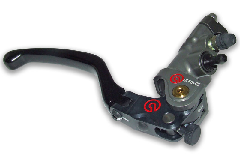

    Ive got a factory spec 18x19 mag brembo Radial m/c, it gives way more feel, way more power and is way less prone to fade, ive got a lightec folding lever & remote span adjuster on mine, came straight from smr racing

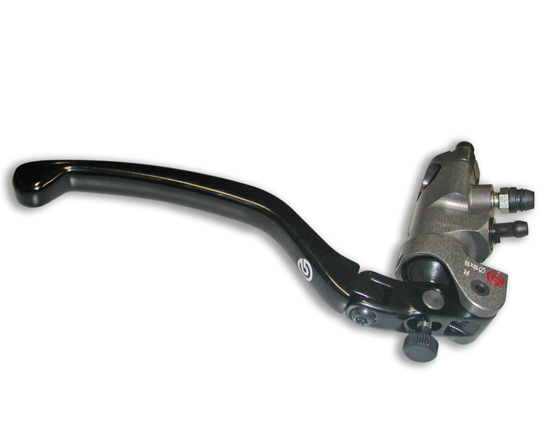

    Nice, The full WSB/MGP spec cnc mag Brembo master 19x18 seen here is £2,100.00! Same as used on Rossi's M1.

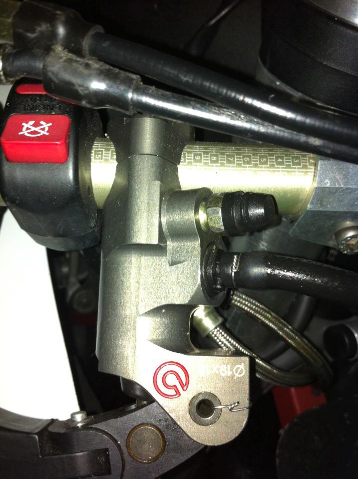

    That be the same as mine then. except it has the new rcs side span adjust, mine is the old front adjust.
    ill take a pic. funny to think thats what they cost, as i paid way way less than that pmsl
