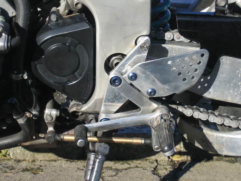

    Hey mark , nice talkin earlier. Can you post more pix of your present set up on this thread please? Need idea of clearances to swingarm and subframe.Also , what is distance apart of top and bottom of rearset brackets? Here's pix of my forward and down adaptors on my RRW;
    Stainless adators, go back and up and when reversed forward and down, also adjustable.

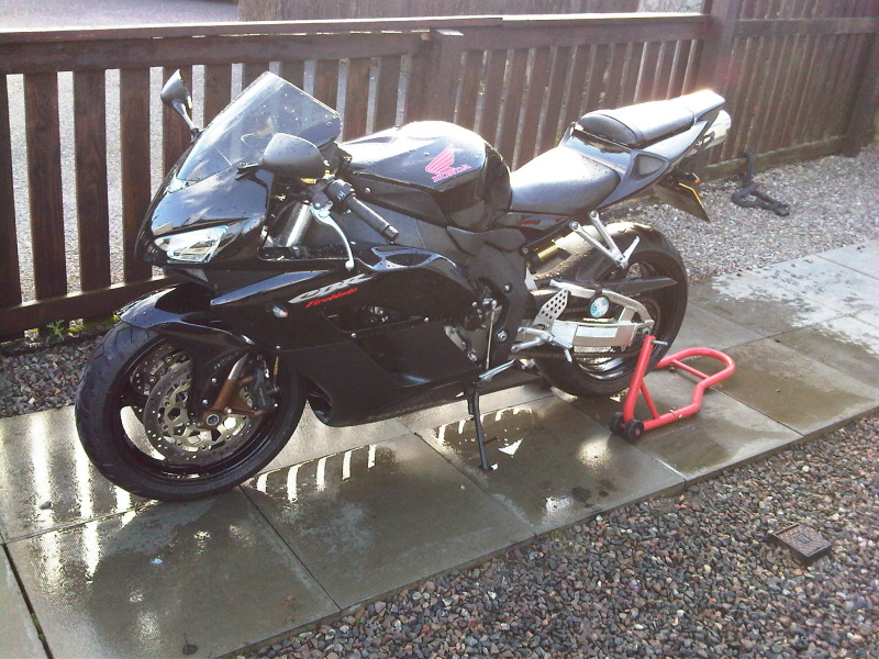

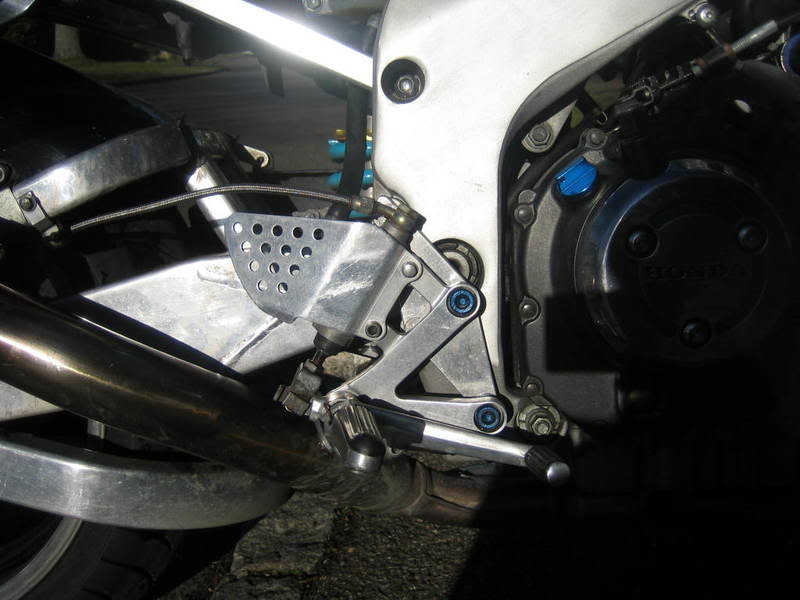

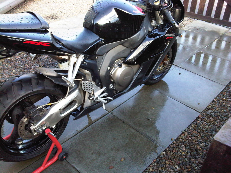

    Here are some pics for you of the RR5, dont think the gearchange needs touching as i will be able to reach it as it is.
