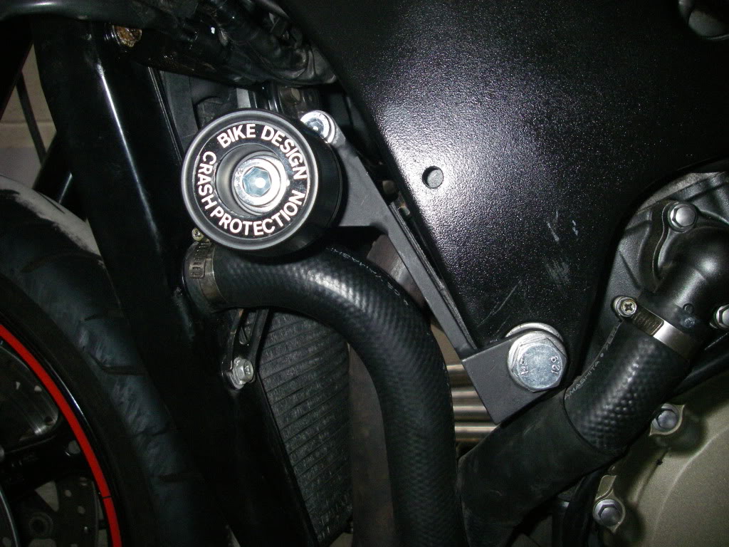

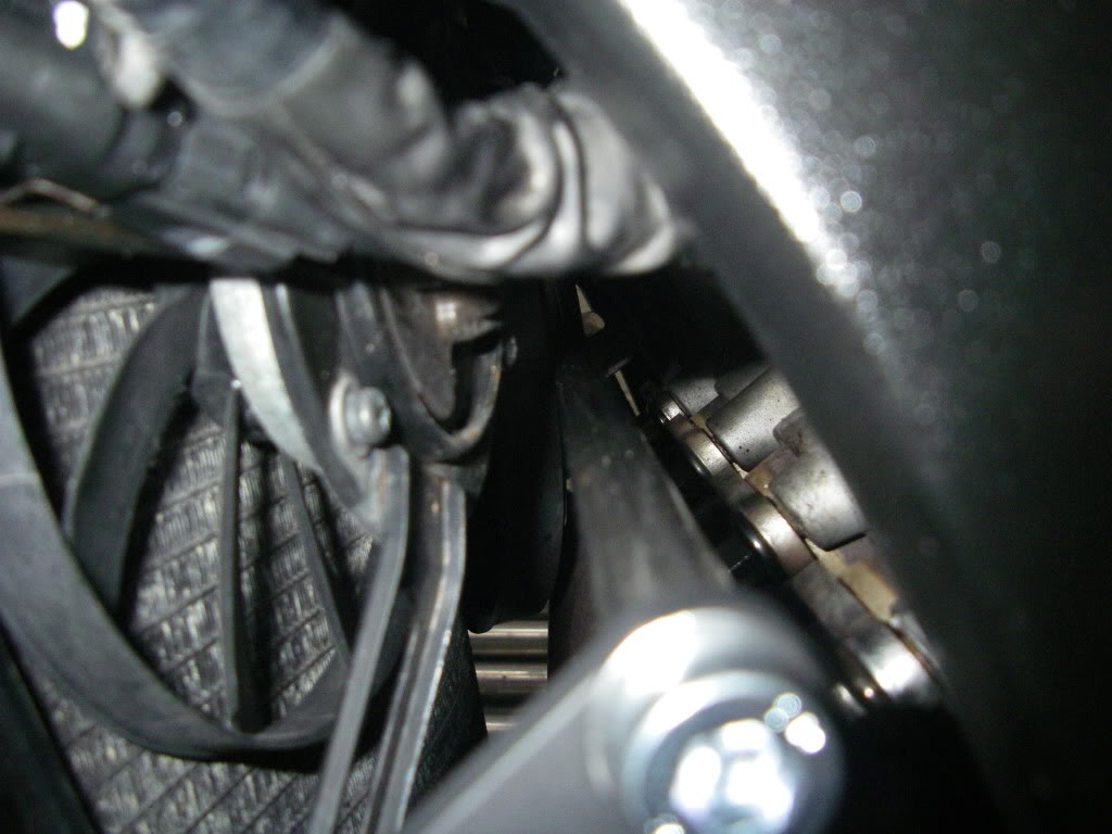

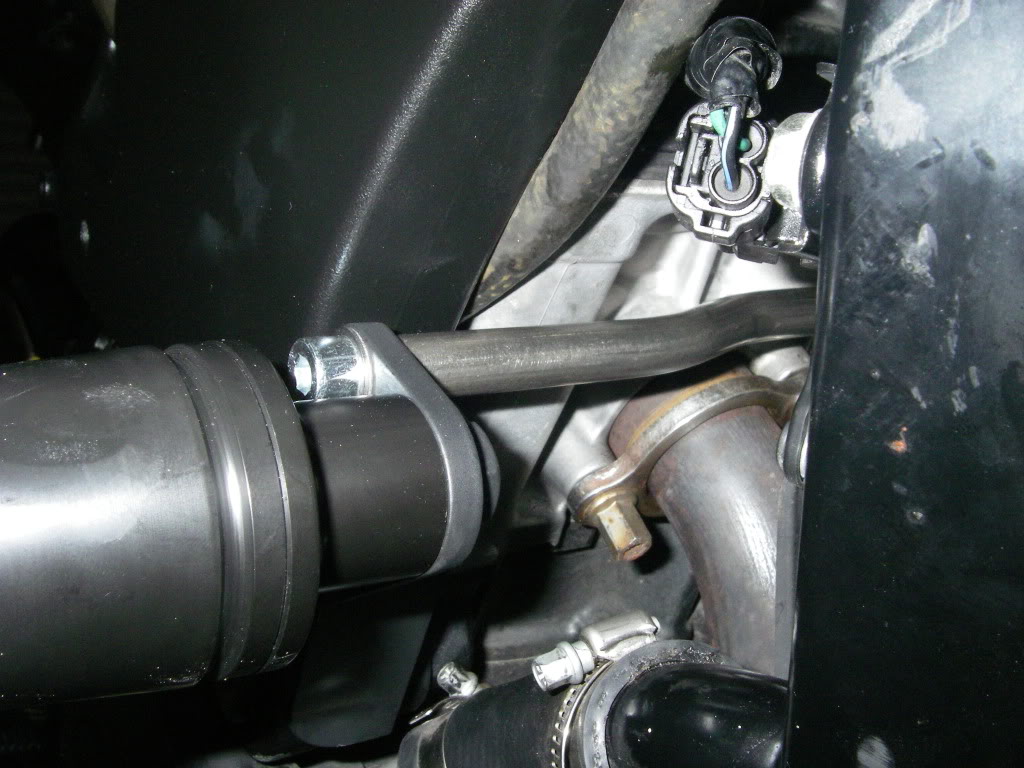

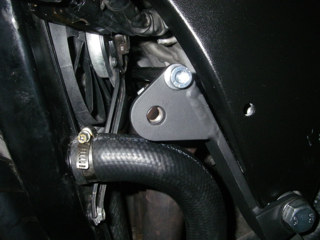

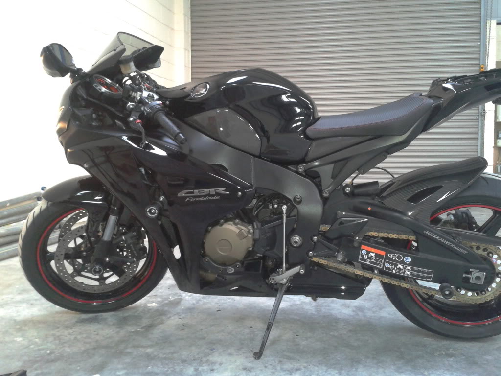

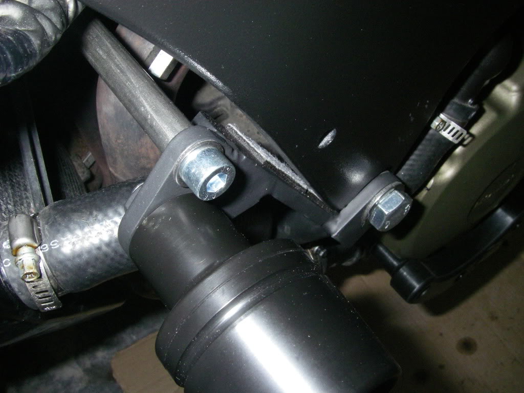

I'm no professional but they are very sturdy, good quality and appear to be well engineered, they bolt into a bracket that is in turn bolted into the same engine mounting point as the R&G but are then also bolted to each other across the front of the bike by a solid SS bar that runs behind the radiator, they really do feel solid and the benefit of not cutting holes in the fairings made the extra cost of them justifiable. A few pics of the fitting.
I feel thats a lot of needless weight when it takes all of 1 hour to carefully bore a hole and fit a R & G bung for half the price! R & G have excellent instructional videos on how best to fit these on their website. Explore this option first before you spend more cash that could be better spend on other bits!
I understand what your saying about cost Dougie that is why i explained my reasons for fitting these and he did ask a question which i answered, with regards to weight, unless your trying to gain fractions of seconds on the track then i don't really see this as an issue as the extra weight ( which isn't that much ) you may gain from fitting these can be lost by removing the standard can and doesn't make a great deal of difference when riding on the roads anyway. Just my opinion.
fair point mate - im just a bit anal when it comes to weight, if you think about all the mods you make to the bike the extra weight does add up, and can effect the balance of the bike slightly. I must admit, I was a bit scared of cutting the fairing! but it worked out alright in the end
They look like a well thought out but of well engineered kit but what concerns me is the additional pressure put on the mounting bolt caused by the leverage of the plate during a crash that would lead to damage to the chassis threads and the bolt. Theres not a lot you can do about this without a directly mounted bobbin but the ss bar would take a little bit of the pressure by spreading it to the other side, although this could lead to both sides being damaged. Cutting the fairing and putting direct mounted bobbins would be my suggestion.
Food for thought on both the R&G and the others. I'm no speed demon and am not worried about the weight issue as shaving off a couple of seconds on the way to work isn't worth worrying about. I'll probably go with the cheaper option as, if worst comes to worst, I can always buy new fairings. Dougie, Lee, thank you both for your answers, I appreciate the help, and fantastic pictures .
After much brain-work I decided on the R&G. I trust their reliability as they seem to be the most popular. This time next week I get the bike; this is going to be thle longest week of my life!!
