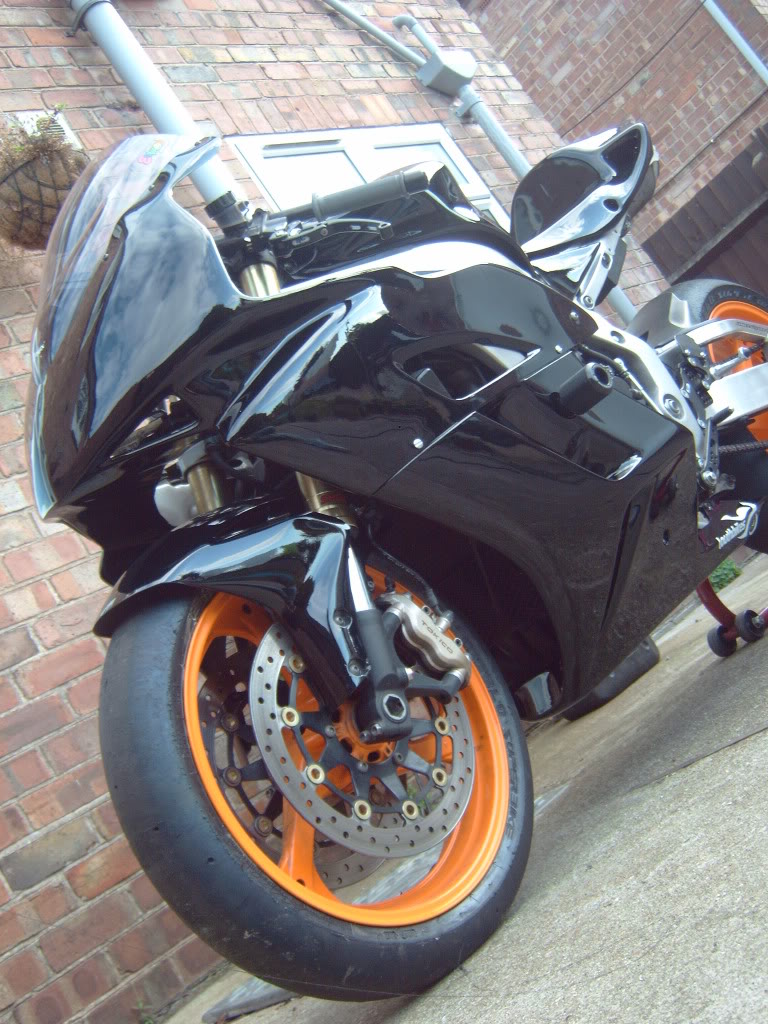

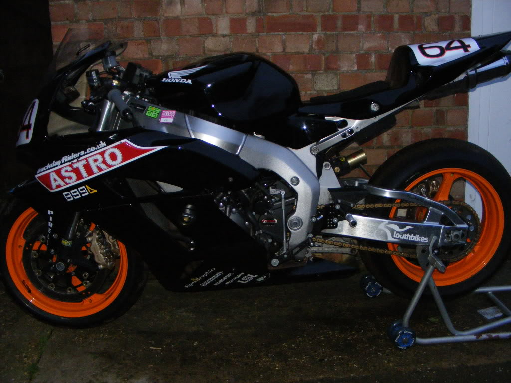

    and now the gratuitous pic whoring....
    as it began....
    as it ran before being seized....
    and so, just like star wars...the story continues...
